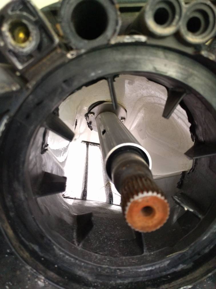

It ended up being the driveshaft guard that was mentioned earlier. Tightened that up and it stopped squeaking.
Is it that metal piece with two screws where the driveshaft comes through the hull? Mine has a little play in it. Wondering if that is normal.
That's the one. Tightened it up and the screeching stopped.
