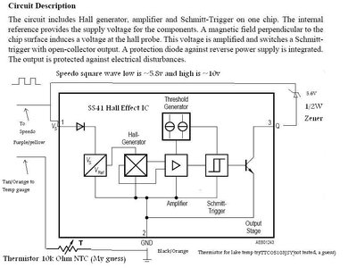

I've been attempting this recently, actually. The numbers I'm getting from my rebuilt sensor seem valid, but I'll have to hook this to my ski and take it out to be sure. I've also seen some guys here talking about adding a 2k2 ohm resistor to the circuit, and I did find one scraping away the potting on the original sensor. I'm just not sure where it should go in the circuit, and it appears from this yt video that its not necessary.

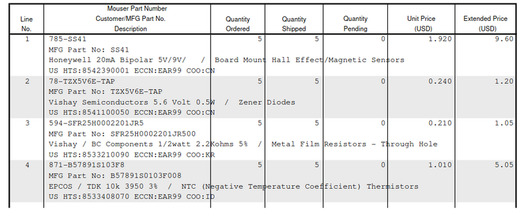

I've included the order i made to Mouser for the components. I bought enough components for 5 sensors, because I'd like to try my hand at rebuilding a few. Should be $2-3 in components for each sensor.
