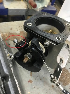

Sorry...What other system would allow me to do this? Is the CanDoo the only way to make this adjustment safely or can I manually just increase this so the on land RPM reads closer to 3000?
Even with the TPS set by computer you still have to set the idle RPM by the adjustment bolt at the rear of the throttle body. Lots of them are stuck and won't move easily because no one ever touches them. Sort of Set and forget. I always get them freed up and moving. . Personally I think you can blow off the TPS sensor reset and adjust manually alone. I've swapped computers and entire throttle bodies with sensors and never reset the TPS and had no issues. My reason for suggesting is you seem to be having issues and the only way to eliminate everything is to set it up by the book. That said... just turn the bolt in a bit and raise the idle. There may be a nut on the bottom of the bolt you'll have to loosen. If the bolt moves easily you can adjust it on the trailer or in the water. It isn't difficult to get to. Good Luck !!

Im just looking at the shop manual for this, there are no details on the nut you talked about, any idea where it would be?
im trying to post a picture for reference
Adjustment; Throttle Position Sensor (Tps) - Sea-doo GS Shop Manual [Page 225]
There should be a lock nut at the bottom of the idle adjustment screw. The throttle body is threaded.

To clarify there is a nut at the bottom of that screw that was circled above. That may need to be held in place with a 10mm wrench for some of you.
I used a socket with an allen key head to make the adjustment of the throttle. She idles now at 3k rpm on the trailer and the oil pump marks are still in perfect alignment. Next step is drop it in the water again and give her a go.
