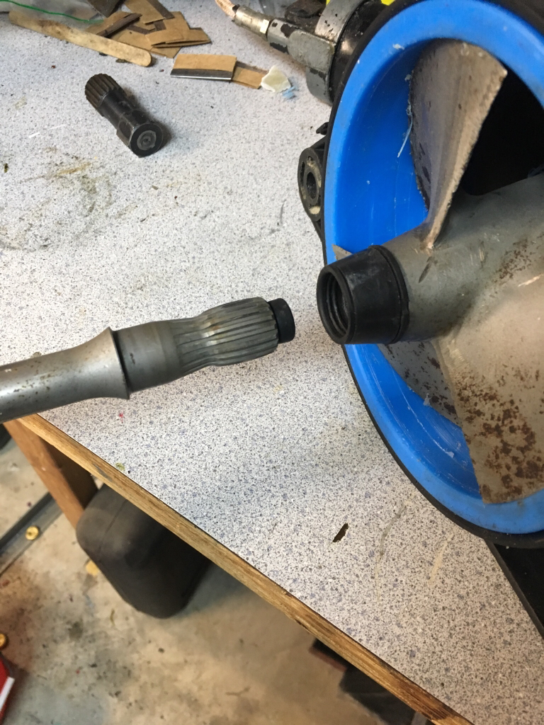

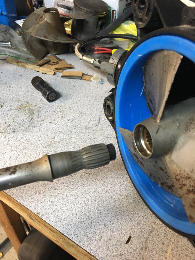

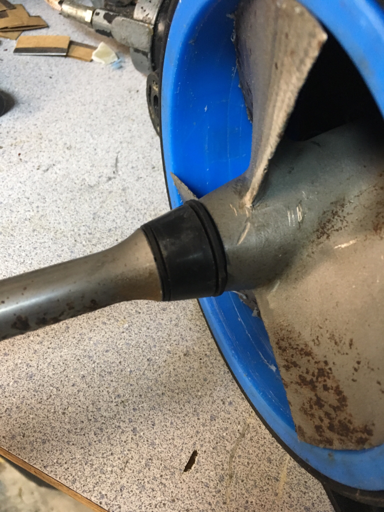

Ok see if this helps.
Driveshaft and pump with no boot.
Driveshaft with boot.
And together.
Is this different than what you have going on?
It won’t let me share images from the app so I’ll try from my computer- but yea, driveshaft has the bumper, the impeller has a cone (but only a cone- unlike the oem that has a soft cone and a hard cone that goes over it) and when I attach all of them together there is always a 1/4 “ gap between the either the shaft and the cone or the impeller and the cone, depending which one I seated first. Either way- the guys in the 2 stroke forum are saying neither of hear things wild cause water to spill into my haul and that it has to be the carbon ring or cracked bellows, but they worked right before trying to install the new impeller.. so I’m just perplexed as to how me installing this damn impeller could have done any damage to the driveshaft setup when I didn’t even touch it. Someone suggested doing it like you’re doing it- taking the drive shaft it entirely, getting the cone to seat and then installing in trough engine bay/hull instead of through the rear.

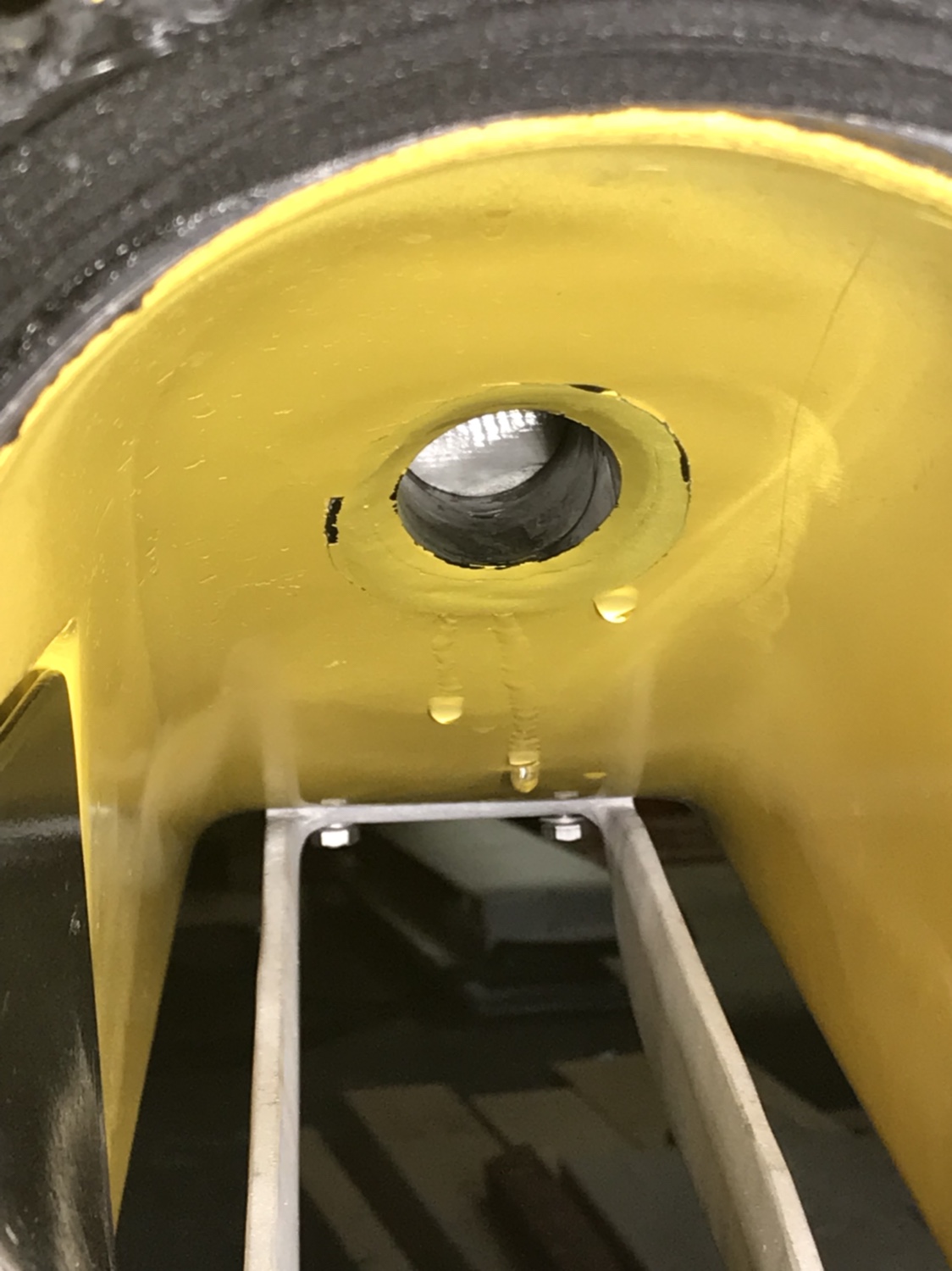

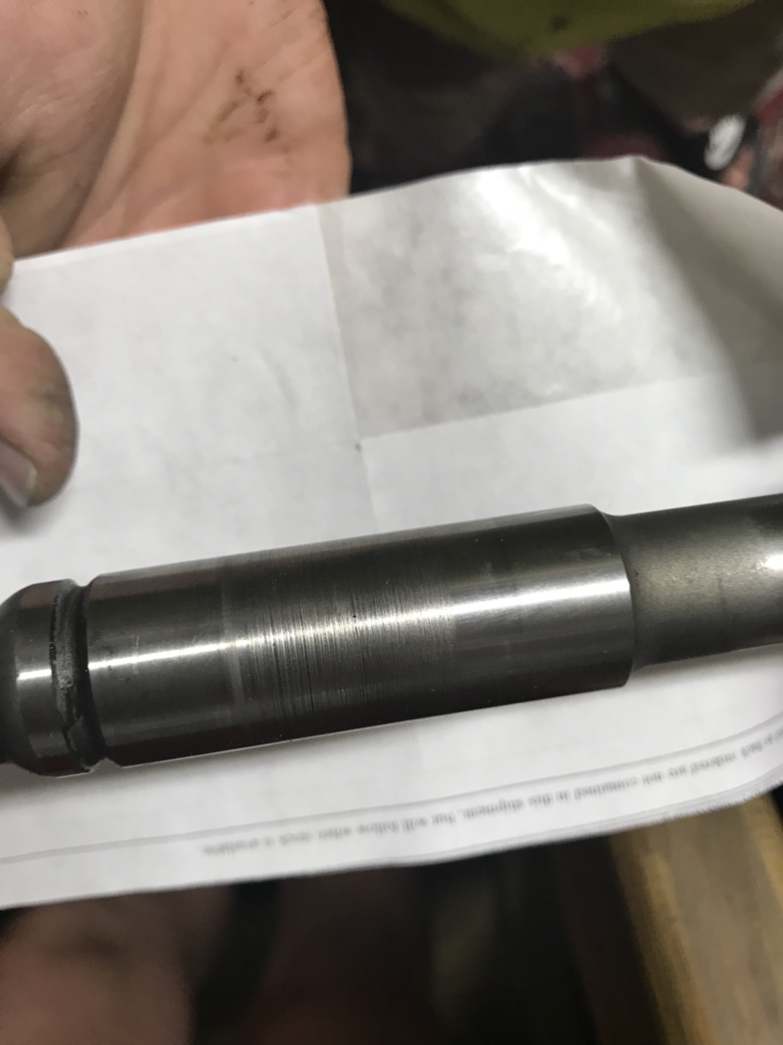

So finally got my fiancé to take of the driveshaft completely and sure enough one of those bumpers that are supposed to be on the driveshaft is total obliterated. So that could have definitely caused the leak, BUT we filled the hull up with water just to the edge where the through hull fitting is (without any of the driveshaft pieces in) and it STILL leaked... my fiancé is convinced this means we need both a new through hull fitting and that bumper- my question is, if there isn’t any pressure from the driveshaft assembly pushing on the through hull fitting, will it still be water-tight? Or would it potentially leak.. I just don’t want to spend 70$ if my through hull fitting is fine. Also- when we pulled the driveshaft out, it has some wear- like little grooves. Photos below of where the water was coming through the hull w/o the driveshaft in, & the grooves of the driveshaft. Thanks. - Jess
