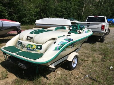

just a note...the plastic hinges on the cooler door hatch(right in front of the spotter seat) and the small hatch on the rear hood tend to break and then you loose the door onto the highway or the lake. they are also hard to find and expensive to replace. find a way to put a tether on them so if the hinges break you will still have the door. I believe there are forums on how to replace the plastic hinges with stainless hinges.
