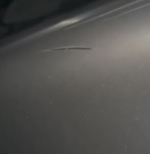

Hard to tell by the picture but does it look like the scratch has went down to the fibreglass? If it has made its way complete through the gelcoat then yes you should fix it. You can do a gelcoat repair which I’ve done or I think I’ve seen many posts of people who have used marine Tex which is an epoxy I think. The gelcoat repair will look better but if it’s on the bottom then appearance doesn’t really matter
