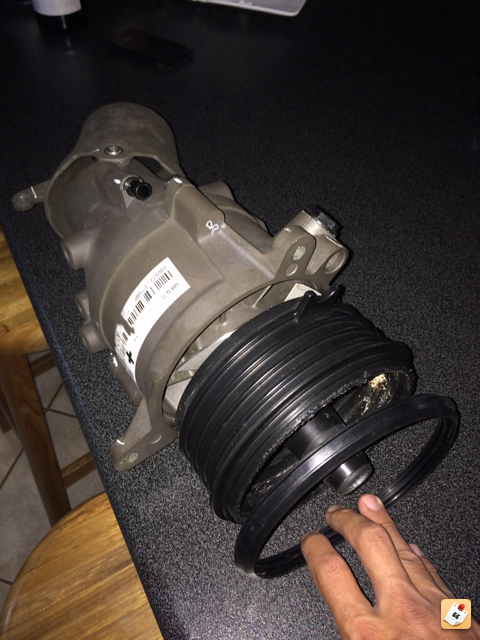

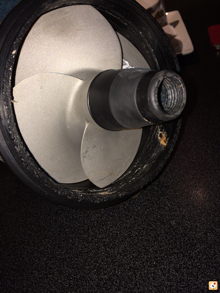

SabrToothSqrl Well-Known Member Dec 27, 2013 #28 Is that the first recorded blown wear ring for a spark?!
L LouDoo Premium Member Premium Member Dec 27, 2013 #29 Parker Yamaha has them, shipping is going to be a bear, but it could save your summer. http://www.parkeryamaha.com/seadoo-spark-wear-ring-267000617.aspx Lou
SabrToothSqrl Well-Known Member Dec 28, 2013 #31 Can you take some photos of how to replace a wear ring on a spark?
R Rickyp5569 New Member Dec 29, 2013 #32 It's really easy, three bolts hold the pump on. Remove water cooling pipe, remove bolt holding steering on. Slide it all out. Sent from my iPad using Tapatalk
