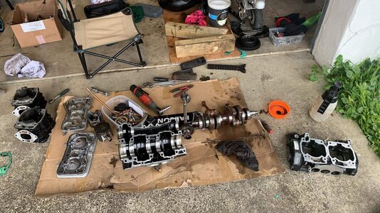

Compresion is 160.
l have some option to try with some parts because my neighbour have same ski.
So can swap same thing to try.
l have resurfaced rotary valve cover.
Restoration to factory specifications.
New rotary valve.
Its not start in water any more.
