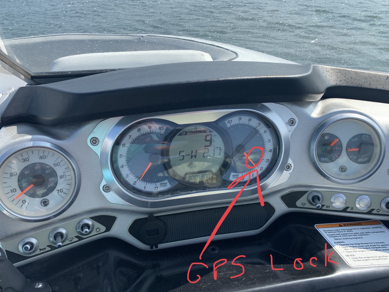

Your 210 Challenger uses a GPS for its own speedometer. No need for a separate one. The internal GPS is used for speed, cruise control, eco mode calculations, etc...
If you look at the starboard RPM gauge at about 2000 RPM, there is a gps lock indicator.
Also it should be pointed out in many cases the analog speedometer is rather inaccurate. The digital speedometer you can select on the digital gauge cluster is accurate.
