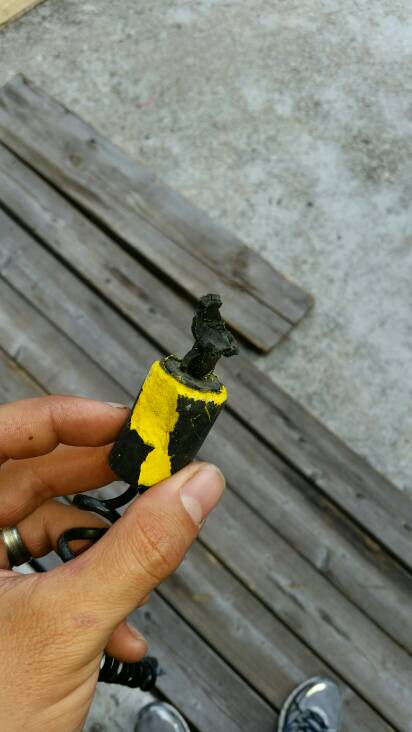

So I can't start the boat because I need a starter, but when I get the starter I won't be able to start the boat... previous owner let something chew the safety key. Local seadoo place wants 55 plus 100 to program. Does this thing really need programing???

it's a Merc boat. There's no DESS in it. All you need is a $15 generic lanyard.
Hope you read this before you take the drive.
Dr Honda, that's the answer I was hoping for! The old one doesn't say DESS on it. But looks like a dog got to it.
I feel like an idiot. I just looked closer at the stuff on the dash, it is definitely the Dess Style. The button that the lanyard would push pin is jammed in on the switch , so at first glance I thought it was just a cap that went over it.
The DESS system was ONLY in the Rotax boats. The DESS post has a metal tip, and ring contact where the chip in the lanyard will make contact. The standard has a plastic plunger. (button)

The Doc is right on this one. I actually had a lanyard stretch just a bit and would not push the button all the way in. I took the lanyard off and pushed the button in with my finger and started the boat up. Drove in to get my spare lanyard.
