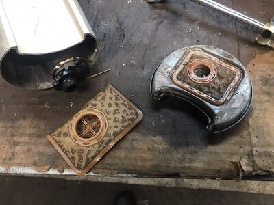

Have you ever replaced the fuel filters in the canister inside the fuel tank. There is also another fuel filter outside the tank. If you have not, those filters are 20 years old and can disintegrate. Your fuel pressures are great and if they are bouncing around... you are cavitating. I replace all of the filters and maybe drain the fuel from the tank. Sounds like the ski just needs some love. :) I love the DI's they are bad azz. Good Luck with it.GTI RFI Fuel Pump Filters (2).JPEG

Have you ever replaced the fuel filters in the canister inside the fuel tank. There is also another fuel filter outside the tank. If you have not, those filters are 20 years old and can disintegrate. Your fuel pressures are great and if they are bouncing around... you are cavitating. I replace all of the filters and maybe drain the fuel from the tank. Sounds like the ski just needs some love. :) I love the DI's they are bad azz. Good Luck with it.View attachment 65651
I actually have a brand new pump and filters that I'm going to install next week. I love my DIs'! Thanks for the info
