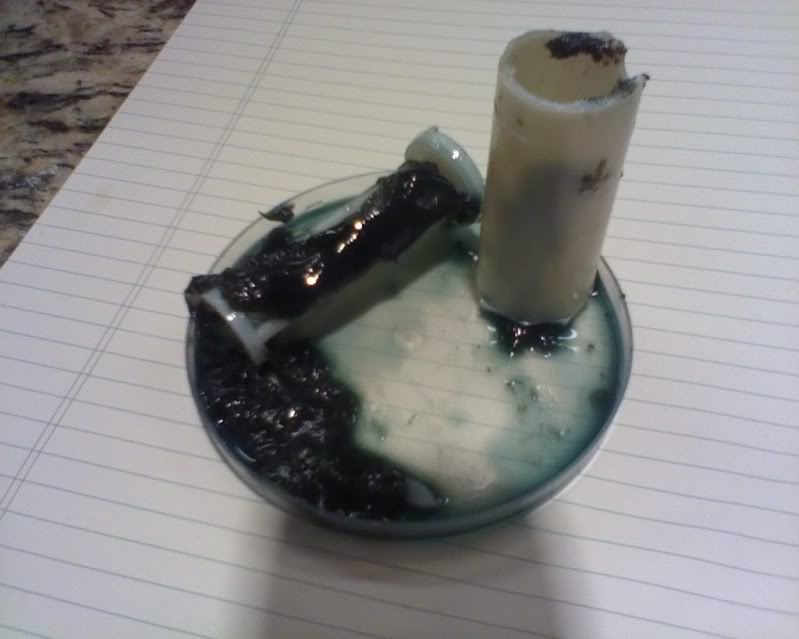

Oh... and the other problem is... the additives packs don't mix !!! The story of... "Do not mix 2-stoke oils" is not just an old wives tale. It's not as bad as it was long ago... but there is still a real issue were mixing the oils (because you just needed oil one day, and you bought something that the gas station had) can lead to the oils "Gel'ing". When that happens, the system plugs up, and your engine get's roasted. This is also why the oil injection got a bad wrap. People would be careless (and cheap) with the oils, and when the system plugged from user error... they would say the pump sucks.
Here's a cut open filter from someone who blamed the oil injection failing, for the loss of the engine. I had to point out, that the pump didn't fail. It was his fault for killing the engine. (by mixing oils) So... if you are changing brands... clean out the tank !!!!!
