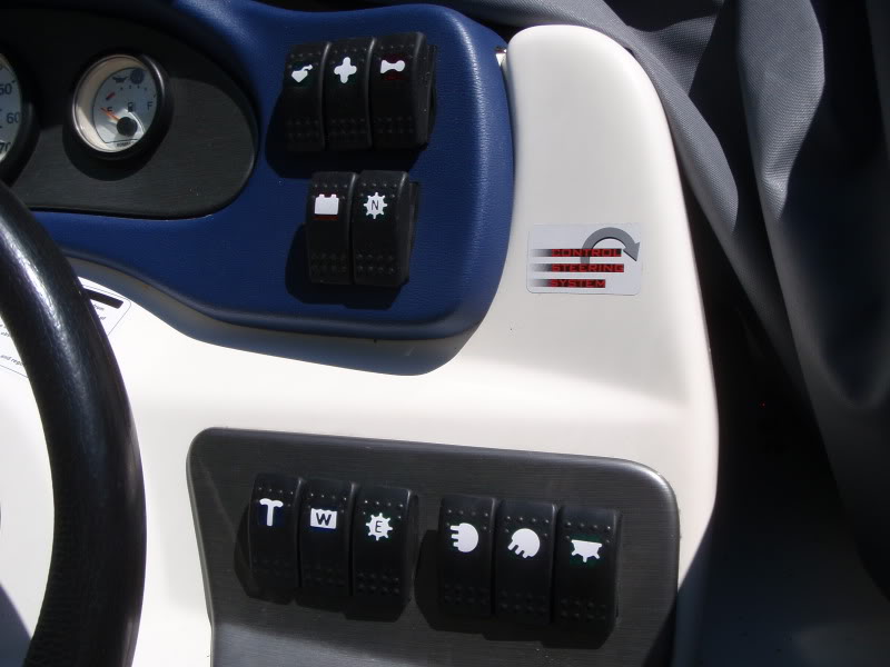

I'm getting new rocker switch covers and since it been about 3 years since we had the boat out last, I'm trying to remember what some of the switches do:
#60 Battery Switch - What does it do exactly?
#26 Light Switch - Which lights do they turn on?
#64 Boarding Light Switch - Which lights do they turn on?
#30 Courtesy Light Switch - Which lights do they turn on?
Thank you
#60) if you push it... the battery blows up !!!!!!!!! LOL. Sorry... couldn't resist.
If you push it... it will quiet the low battery alarm. It's set to come on before the battery is too low to start the engine. SO... the threshold is actually high. If you have on some of the lights (especially the dock lights) or the blower... chances are, you will hear the alarm, even on a good charge.
without having your picture in front of me... I'll have to guess a little....
#26) this should be the majority of the lights in the boat. (switches, gauges)
#64) This is the smaller front "Head lights", and the floor light in the rear of the boat, by the shower. (The docking light is the front bright headlights)
#30) This should be the floor lights.
There were a few minor changes over the years... so put the year of your boat in your watercraft description.
My switches may be different, depending on the year of your boat, and I made some new icons for my switches, but they are similar to the originals. (That were faded to nothing) I'll list them in order from left/right, top/bottom.
FYI... you may have a fuel switch too. (I don't have it)

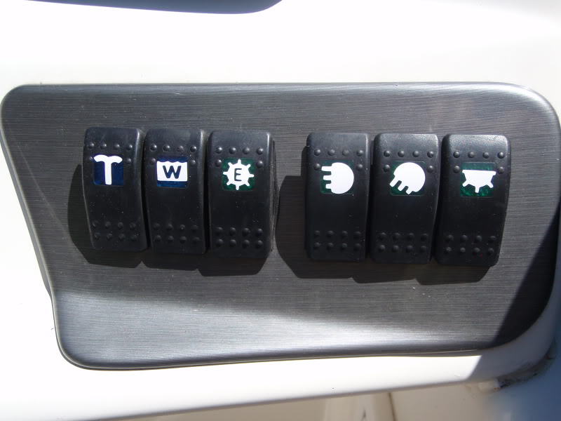

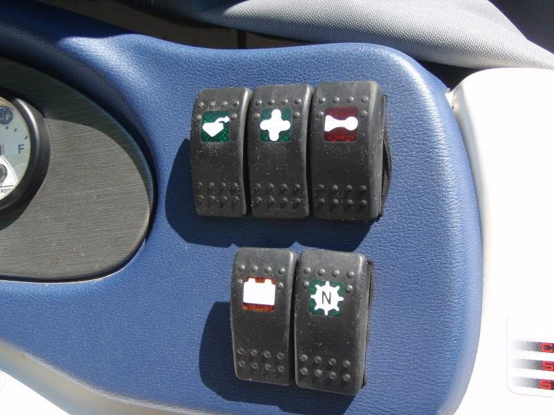

Bilge pump, Blige blower, Horn
Battery, Nav lights. (NAV is 2 position. first is just the anchor light, second all)
Fountain, Fresh water (sink/shower), Engine compartment light, Dock lights, Boarding lights, Courtesy lights.
