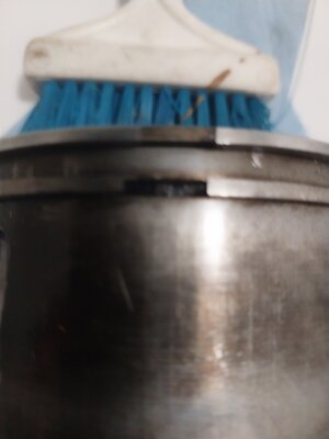

717 2 stroke, It has 2 ring groove, 1 groove is narrow does not have locating pin, the other groove has a locating pin worn down flush to bottom of groove, can I locate the ring gap over the location as a reference, I can not see how remainder of pin could ever be removed, without damage to piston groove, will it be OK to install in piston and hold that position

I’m looking at an old piston of mine and the pin is recessed, but it is there. It would really be your judgement if the pin is there or not and if it would stop the ring from rotating. What’s the background on the machine, what happened to it and what are you doing? Maybe @mikidymac can advise you?

The pin seems it could stop ring , I just ran a scribe and could feel the head if pin. The top ring groove with is .040 and the one with locating pin is .080 I put a new crankshaft in, leaking center seals, and bad outer bearing, which may of caused slight bent rod
Yeah, I just went and checked an old piston I have and there’s not a lot of pin sticking out, wish I had a new piston to look at, I can’t remember how far they come out when new. Anyways I will leave it up to you but I would not use it if there’s no pin on the 1 groove.
I just did a little research and that top dyke ring ( semi trapezoid ring is supposed to have a pin ) Also Mikidymac mentioned in an earlier post on here that it does as well.
