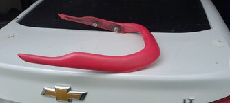

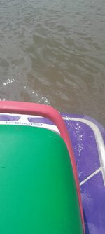

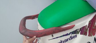

Hi everyone, i recently bought a XP from 1996 (last week), the engine it's ok but it has some aesthetic problems.
I want to get back the color of this part, i tried everything, someone did it? (sorry for my english i from argentina)

I cleaned this one up but it was t as bad as yours. You can see how I did it on page 3 of my 95XP thread. After the scotch brite use the Coleman’s in a micro fiber to smooth it out as your basically melting some of the material off with the Naptha
thanks you both, it's a lot of help,it's not to much info in spanish. I understand now that my xp is 93, maybe when someone brought it to Argentina registered it like 96. i will try with naptha .
