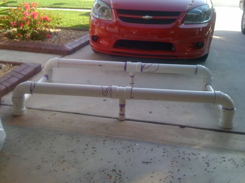

Built a PVC PWC stand for my seadoo yesterday. very simple and affordable (60 dollars at home depot which included glue and primer) very, very sturdy and simple to make. holds my ski with no problems. didnt really need the wheels since i would not be moving the stand around.

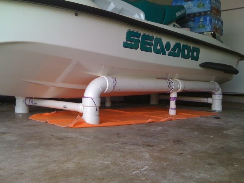

my dad and i put the ski on the stand ourselfs and to put it back on the trailer two people would be able to get it close enough to the trailer that you could winch it to the stoppers when you were putting it back

used 3in PVC for the whole thing except for the joints that connect the two sides which i used 1 1/2 inch piping. (using the 3in was getting expensive and the smaller diameter stuff worked just as well)

it would be, but i was looking to keep cost low, since the ski is for sale and i really didnt need a rolling cart. but i could always still make this stand a rolling one in the future if i change my mind
Very cool and I am all about low cost! Do you think it would hold my 96 GTX? I dont believe it is much heavier than the one shown. Great post!
im sure it would, the stand felt very sturdy and i had 3 200lb people sit on it while it was on the stand and nothing happened.
