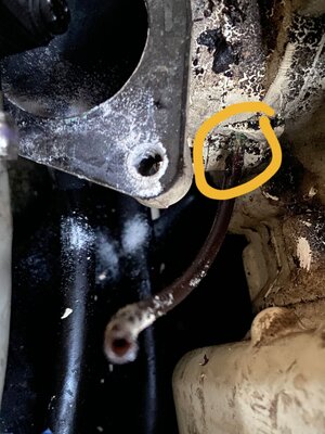

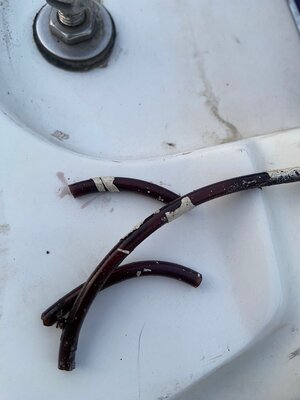

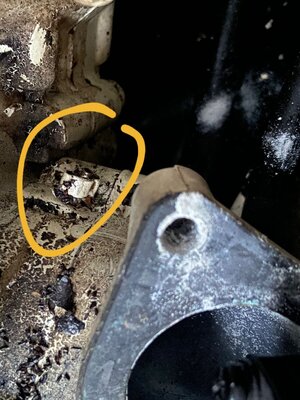

Okay, I finished rebuilding it, it was very clean inside, just some screws were stripped. I siphoned out all the fuel and have some new untreated fuel. When I was removing the carburetor, I noticed some fragile cut pieces of tube on the bottom that were filled with the 2 cycle oil that was leaking out earlier as I mentioned. I'll post some pictures of it here, I could get some replacement tunes for it but I don't know what it is called or where to rout it at. Isome piece of another tube was connected to a needle valve of some sort. Do you know what oil line it may be and where it connects?IMG-20230816-WA0001.jpg

3AD28A37-97D1-49AF-B40D-A4C355A5EBD6.pngThose are your small 3/32” oil lines from the oil pump to the fittings on your rotary valve cover just beneath the carburetors. You have the fittings circled in your pictures. You can get that line aftermarket at lawn mower shop, I prefer to buy OEM for these lines just to ensure it’s quality line and proper fit. Part number is in photo, 1500mm will be enough to do 3 or 4 machines.

You will destroy the engine running it with those little oil lines broken. They are the only thing supplying oil from the oil pump to the cylinders and crankshaft.

Thank you, I knew these lines supplied oil to the engine, that is why I have not started the engine. Is there a tutorial on flushing the oil system?

Install new 3/32" oil lines. On your ski they are on the intake manifold under the carbs and are only a few inches each.

Where would the oil injection system be located because I already have the 3/32 lines already connected to where the carbs are.
