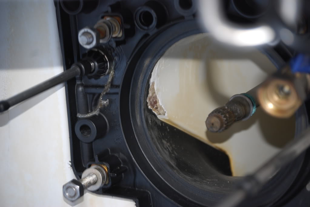

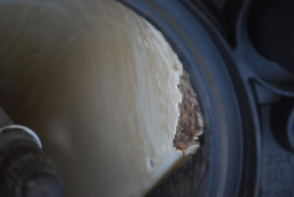

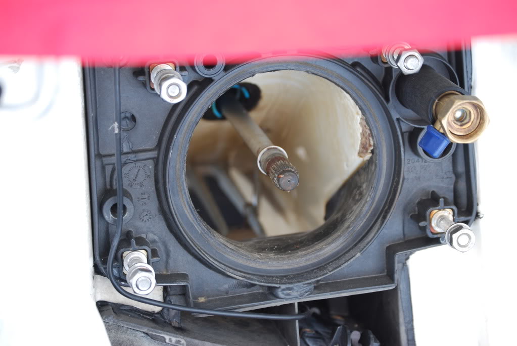

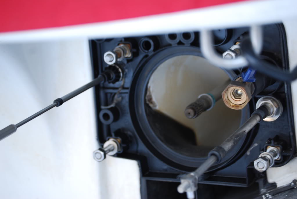

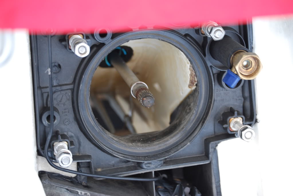

Hey Guys, got my carbs sorted out (thanks again Dr Honda). Now I'm on to my pumps. I've just removed them and noticed some serious water scoring on my hull. There a good DIY product to fix this up that anyone knows about?
Thanks lots!
If that was my boat... I would clean it up with some acetone, make sure it's dry, and cover it with some epoxy. It doesn't have to look pretty, but you want to seal the open glass, and smooth the edge.
Epoxy... Think I've got some layin round. Thanks. U guys seen this on your rigs ever?
