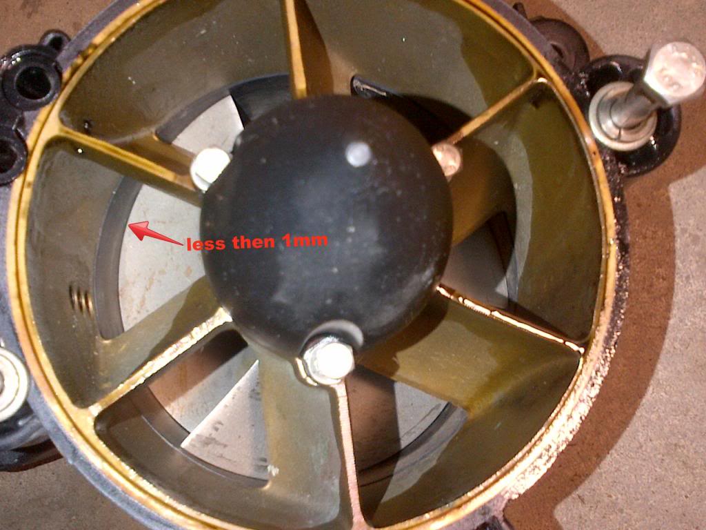

Look inside your pump from the bottom of the boat or from the venturi side and try and get a measurement between the wear ring and impeller, it should not have more then 1mm gap. Check for damage to the surface area of wear ring and impeller

On your picture of the carbon seal the larger boat is loose. Where it goes over the actual carbon seal is where it is loose at. Could that be the problem and if so is this something that is difficult to replace and where would I even begin to get the parts. Also, I am pretty sure that the wear rings have not ever been changed just because the original owner didn't do any other kind of maintenance so my question would be how hard are they. I have read some other forums on this and believe I could do it but I am afraid of not having all the parts. Like when I pull off the assembly is there a gasket that I need to have. Also I have searched for the impeller removal tool on eBay and am not sure which one to buy. However, I think you are dead on what my problem is and I really appreciate you posting the pics as well that was really helpful. I would have not known where the carbon seal is.
