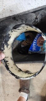

It was the pump.Looks like something hard went tbrough the impeller and chewed up wear ring and damaged blades. Incredible must have happened on first launch after rebuild.
