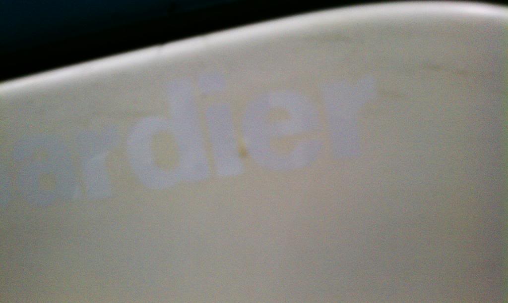

Now if you are not going to keep the decals do this.

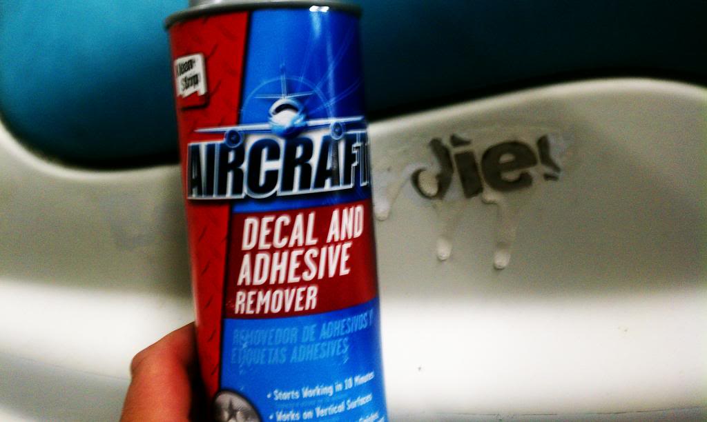

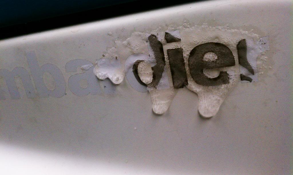

If you have not removed decals before this is very simple. Use a heat gun, turn it on and keep it about 3 inches away from the decal and use circular motions over the entire decal you are about to remove for about 30 seconds, with letters i do one at a time. After the 30 seconds try and peel up a corner as shown in the pictures, if it starts to come up easily keep slowly peeling it back on an angle. You should be able to remove most of it in one try. If it starts giving you trouble or isnt peeling up just go over it again with the heat gun. Some decals come up easier than others and larger decals will nee to removed in sections sometimes.
After peeling the decals sometimes you will have some residue from the adhesive left behind. This is normal and easily handled with the aircraft decal remover. First just spray the area and let it sit for about 15-20 seconds and then wipe. it will smear, just spray it again and wipe it clean, simple as that.

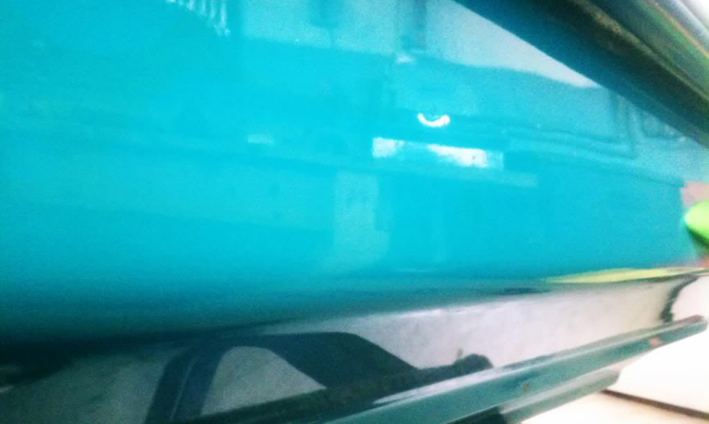

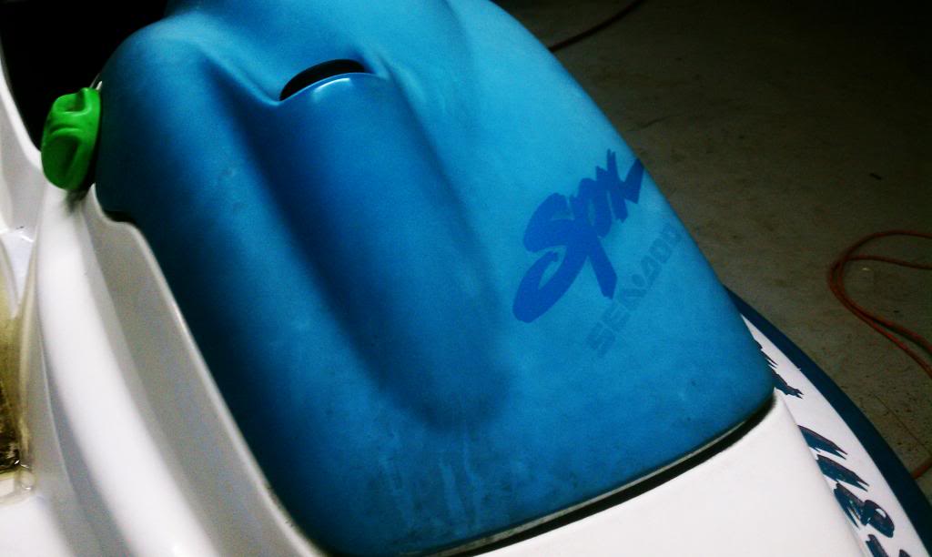

Okay Now to the buffing. I use a good dewalt drill with the above mentioned attachment, I use this over other buffers that I do own because it can get into the footholds rather easily and is easy to manuever aroung all the little creases and edges. This is the hull that i will be cleaning
Some more. This hull has alot of yellowing you can see it around the old decals and the teal is really faded the picture doesnt show how faded the teal really is

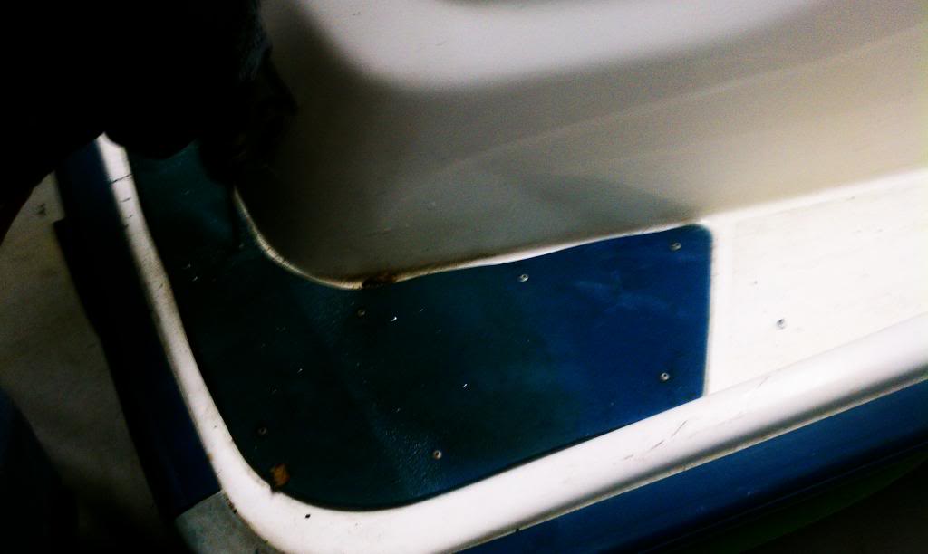

Okay here is the last of the before pictures. As you can see i removed the footpads because im replacing them with blacktip pads. The reason im using blacktip is they are cheaper. On my personal machines I use hydroturf, I think they have better designs with there 2 toned but they are more expensive but here is a tip. If you buy from them at checkout there is a comment special instructions area. If you are a member of this forum simply enter. Seadooforum.com member, and your member Id then 15% off. I have done this multiple times and when your items ship you will see the discount. at checkout your total will not change because they have not manualy added the discount. You can call to make sure if you are hesitant.

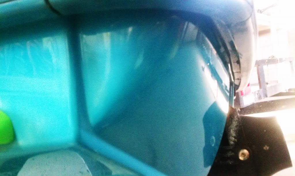

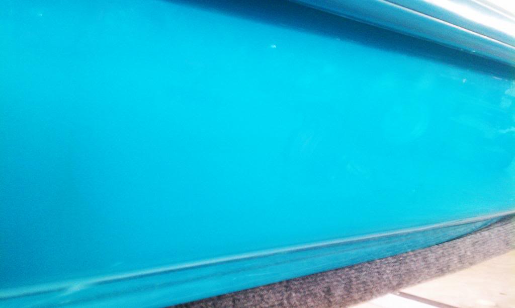

Step 1 in actually buffing
Start by attaching the buffing pad to the drill and apply a generous amount of compound onto the pad. With the the drill off smear the compound onto about a 1ft by 1ft section. Use a good amount of compound, the area should amost look like you painted it with a brush, dont worry thinking you are not going to have enough compound, you wont use that much by the time your done. Turn the drill on working that section thoroughly, apply a decent amount off pressure but not so much that the drill drasticly slows, move the buffer up and down, left to right. You will notice the compound will start to thicken and even dry, This is good. When the compound is almost dry keep going over it and the buffing pad will absorb the rest of it. Dont be scared with the pressure or think you are over doing it, this gel coat is really thick. after that section is done just keep moving from section to section slighty over lapping the last area. I usually tend to due the top of the hull first then go to the bottom, the reason i do this is the hulls sometimes are 2 toned and the pad will absorb the color as seen in the pictures below, the pad is now a teal color. To get into the curves and creases just manuever the pad on angles I usualy do not use the pad flat against the hull. After the hull has been completed, wipe the whole hull down well with a clean rag. Then wash it again. The reason I clean it before the next step is that when you go to the next compound the next process is to use a product that is a finer grit that will buff the slight swirls that the last step has done and to smooth that out, but if the old grit is still there then this defeats the purpose of the next step.
There is almost instant gratification when doing the heavy cut, especialy with any color but white, The color will be deep and a dramatic difference. I would say that the white hull is the hardest to clean. Just so you know going into it if you have a white hull it takes more time and sometimes may even need to be wet sanded a little, but I have not had to wet sand this and I have never had to wet sand a yellow, red blue or black hull.

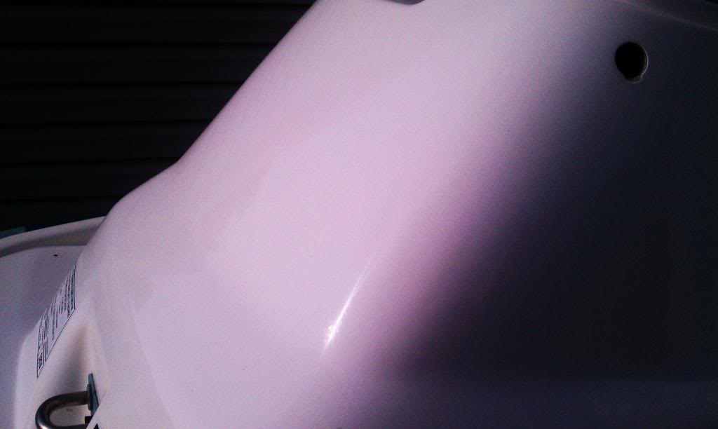

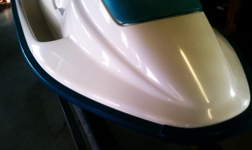

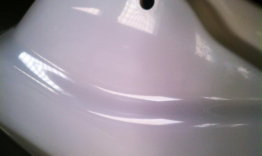

Here are some pictures of this one finished.
I Did not tape anything off because I am painting all the trim and putting on a new seat cover and pads just if people were wondering why I said to do it but I didnt
I am sorry i didnt get more pictures of the actual buffing process, but it is hard to buff and take pictures of it by myself. If I can get some more of actually buffing i will insert them later. I will also be putting up final pictures with the painted trim, hood, new seat cover and pads.
