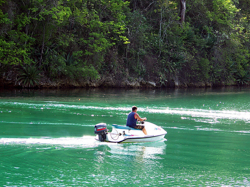

Being constructive
I added to, as best possible. Truth is, most UK folks probably know someone with fiberglass skills. I know it sounds crazy, but it seems every cool, outlandish project, I've ever seen, has a how to with a bloak in his garage holding nothing more than a hacksaw and a bit of aluminium.
