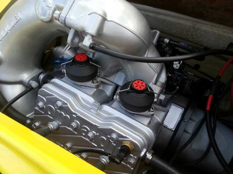

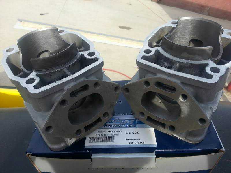

Build it yourself and save some money all around.
Top end at full bore will be $300,
you can get a oem rebuilt crank for $350 from scspowersports in Michigan, and a rebuilt counterbalncer is only $75.
You will need about another $100 in tools and misc items like ,locktite, grease, yamabond or similiar, flywheel puller.
This way you know exactly what is going into your motor.
There are many threads on here showing guys rebuilds like [MENTION=57920]racerxxx[/MENTION] thread the clapped out 96 xp.
We have a few threads too.
Here is one of the ones we did
