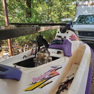

Looky what I found. Ugly 96 gts but it has all the parts I need

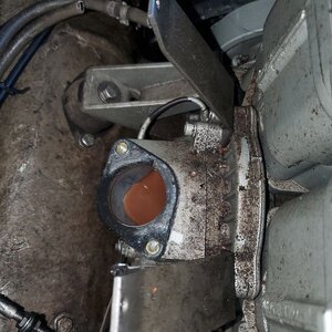

I am back to work on it. I bought another mpem and it tries to start now. I guess it true they only work 1/2 the time. Starter is dragging really bad. Plus the solenoid is sticking. Had a heck of a time getting the starter off. Ended up taking off the exhaust and turning the engine sideways. I posted in another thread that the engine was full of rusty liquid. Ended up being the trans fluid I poured in the cylinders to free them up.

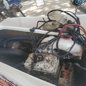

Ok here is the cool part. The engine looks new. I can still see the crosshatch in the cylinders and there are no scratches on the pistons. There is some discoloration from where it sat up for so long but I think i will be fine.

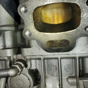

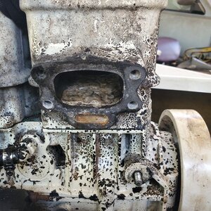

I got this funny feeling this isnt a good engine. But it did have a starter. Yes that is muck in the exhaust and a crack in the cylinder. Funny it spins freely.

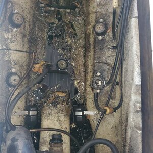

spent the day yesterday cleaning to muck out of the bilge. I also removed the stickers since they were faded . Not as easy as it sounds. Lol

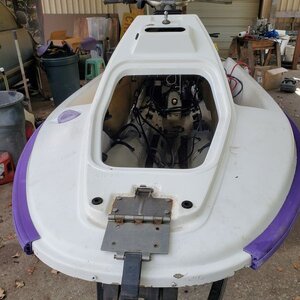

Got the tanks out and cleaned under it. Also got the ride plate on. I am trying to decide. Should redo the gel coat or paint it?. Or just leave it. It will be a fun running around ski but its not worth to much to go crazy on it. In the end its just time.

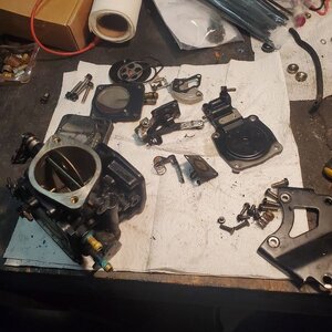

Got the carb kit in. Thanks Mikidymac for the tutorial it helps a lot. I bought the fancy screwdrivers and the pump as well.
Wierd as I was disassembling the carb the high speed screww was closed tight. I wonder how that affected the running. Should I back it out 1.5 turns? Also I read some where that you can delete the accelerator pump and put a bigger main jet in for more power. Anyone know what size jet and will it work?
HS screw should be closed on a 2000 GTS.
No additional power will be made by removing the accelerator pump. Just make sure it is spraying and move on.
