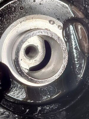

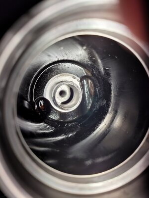

Attaching photos. If there was a way to get underneath to visually inspect that would be great. I see there is a hose nearby but I'm not sure. I maybe taking a trip to the dealership to tell them what happened to fix my mistake. I have not turned it on since this happened.

If the oil is pressurized and enters the assy through the side...goes through the filter then exits in the gap at the bottom, the space down there is part of the pressurized side of delivery so the area down there is extremly small. I can't see how if it fell in there that it is not just sitting there unless it went through the internal line.
I wish I knew what it looked like exactly there because I just can't see how it would be in there.
To be sure, take it to the dealer. What a bummer though.

Thanks for the additional information. This happened because I wasn't paying attention and returned the oil filter to the housing without the nut at the bottom of the assembly. I realized my mistake after putting the filter back in. I then removed the oil filter and the oring the bottom that goes above the nut was gone. It was a loose fit so I assume it came off and fell in that gap. I used a fiber optic camera and can see quite a bit with it but don't see it in there. I tried fishing and a small vacuum tool but can't find anything.

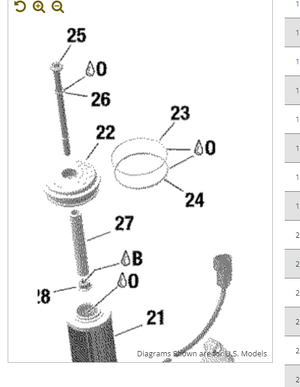

If you put the assy back in without the bolt and tightened it, the bolt does not have the nut to stop it from going in deeper than it should. This most likely would have put enough force on the o-ring to split it. The o-ring is on the outside of the cap in between the top bult flange and the cap. I am guessing it was there in the cap when you pulled it all back.
You would have to pull the cap out of the assy (#22) so I can't see how it would have fallen inside.

Thanks for this diagram. To clarify the O-ring was on the bottom ledge on part 25 (bolt) in this photo. It doesn't show one in this diagram so perhaps there never was supposed to be one there in the first place. I can say it was there after the dealer services it so when I attempted to change the oil myself I replaced it not knowing it appears to not be part of the assembly.
The top o-ring on the bolt is still there and in one piece. I ended up dropping the sea doo off at the dealer. Hopefully they can help me with what is probably a unique situation.
