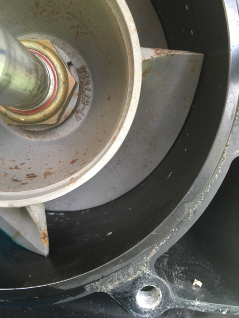

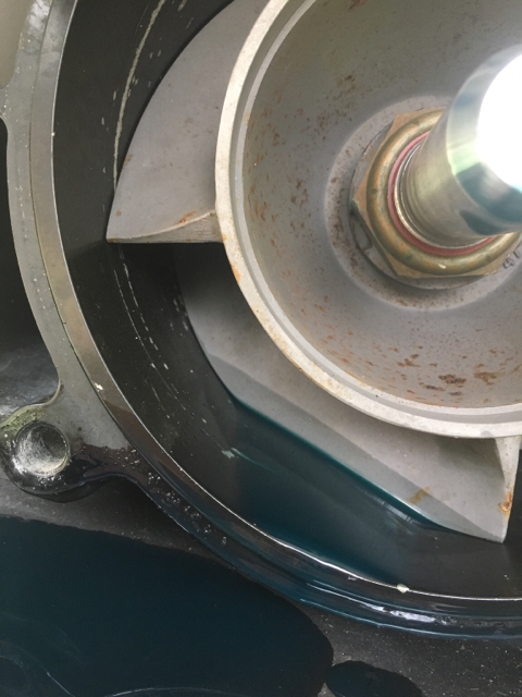

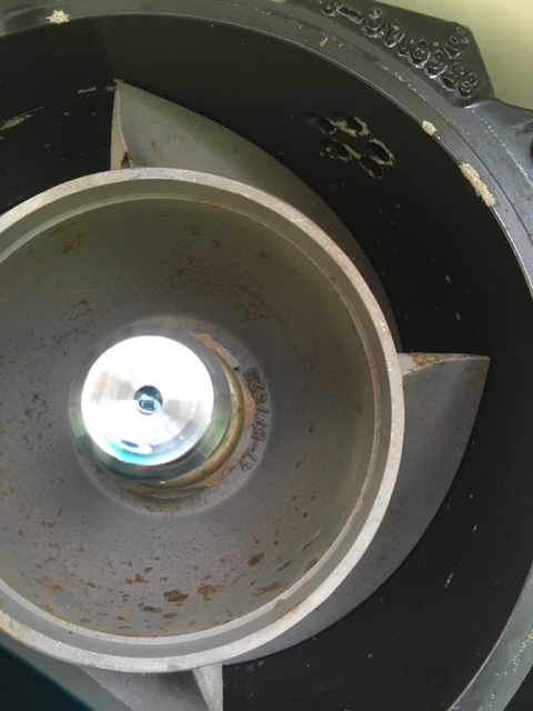

I've diagnosed nearly everything with the M2, and recently bought a DDT just to be sure. It indicates the motor runs fine. There's an obvious power loss in the water even though on dry land the motor sounds normal on the hose. I'm convinced now that it must be something in the drive unit. I've pulled the stator and am trying to assess the impeller. I was hoping I would see obvious damage to the wear ring but I don't. Short of pulling the impeller and going deeper into the drive I'm out of ideas. What do you guys think of the wear ring/impeller photos? Any other ideas?

1) from the pics... your impeller and housing look PERFECT !!!!!!!!!!!!!!!!!!!! BUT, if there's a small hunk of crap stuck in it... then that will keep the boat from moving. (and cause vibration)

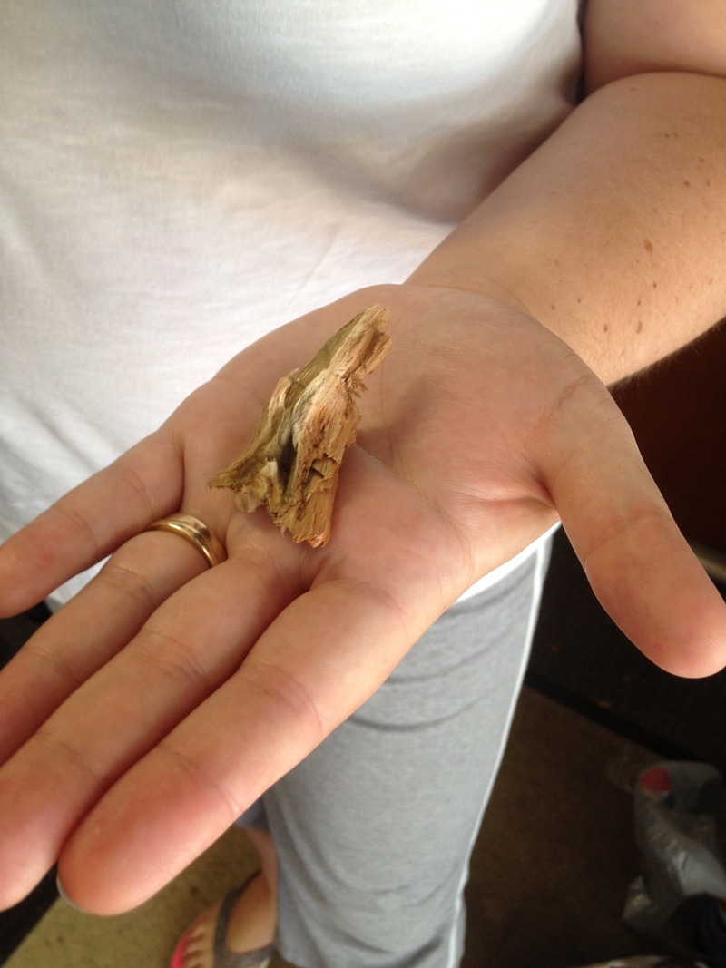

With a jet pump... they are generly tolerant of debris. I can suck in grass, and small branches, and just spit them out. But, once in a while, I will suck in something I can't pump out. (trash bag, plastic bottle, or a thick branch) At the end of last season, I was heading back to the dock (slowy) when I felt something hit the pump. When I pushed the throttle to spit it out... it was a no-go. At 3000 rpm, I could feel the vibration, and "Loss of traction". If I pushed the throttle any harder, it wasn't going to go any faster. Since it was the end of the day... it didn't mater. Once home... I got a bore scope out, and found a small chunk of crap wedged into the impeller.
I can't see into the impeller from your pics. So, make sure nothing is in there, and that there isnt' anything wrapped around the driveshaft.
Here's what crippled my boat, and made a BAD vibration.
