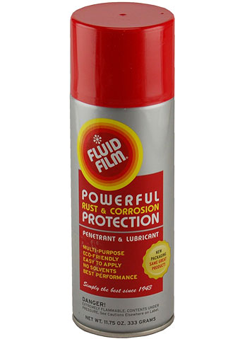

consider getting a can or two of fluid film as well, great stuff ! like $12 online $15 locally, (John Deere has it), really great stuff, if i'm docking on salt with two jet engines, i'm going to be spraying it liberally and often.
