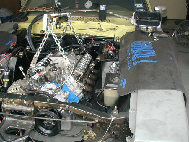

Description of this motor
5.0/302 +.040 for 308 ci total, converted to roller cam, .531/.567 224/232 w/Crane 1.7 roller rockers, GT40 heads (Cobra Mustang heads), 750 Holley double-pumper carb on the old Edelbrock Torker 289 single-plane intake (NOT the Torker II), 3.80 Ford 8" rearend with minispool (REAL posi, not that limited slip crap), CalTracs traction bars, Hooker 6901 headers, full dual exhaust ending with a pair of Flowmaster Super44 and dumping right behind the axle.
Should have about 9.5:1 compression, so still unleaded-friendly.
The car had most of this for a while, but I leveled out a cam lobe and lifter a few months back, and found a brand new rebuilt block for $200, never been run. I then put all my stuff on it, and was given a roller cam, roller lifters, and all the stuff to convert the block to a roller block.
I only had to sink about $400 into the entire new motor. For block, double roller cam chain and sprocket set, new springs, retainers, locks for the valves, machine and cleaning of the heads, gaskets, paint, etc.
