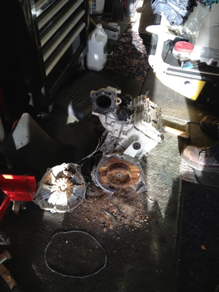

Well I finally got a chance to get stuck into the two ski's and can safely say I have discovered why the first one was having electrical issues .......................
Yes you can indeed see holes right through the mag housing due to corrosion !

The second ski we bought has a seized engine, however its actually not too bad. One of the main shaft bearings has locked up and the needle bearing on the rear conrod has gone so its fully stripped down now and Ill get parts to repair it.
WOW, I thought my XP engine was bad yours takes the prize. My jaw is on the floor right now, I'm staring in amazement that the aluminum rotted out, I'm speechless. I can't wait to see your progress, I love a good brought back from the dead thread. Keep up the great work!:thumbsup:
Yeah I thought my stator and mag were bad lol no where near as bad as that, does that engine still turn over by hand then ?

Britrick, sadly no, when I finally managed to persuade the rotten flywheel to come off the crank with a big hammer and a puller the bearing behind it was a complete mess, on stripping the lower crankcase off it the mag side conrod has completely seized onto the crank to the point where it looks like its all one piece ! I never managed to get a photo of that though Im afraid !
Luckily and strangely the casings are all ok, only the mag housing and cover are destroyed. I managed to get the crank out and it looks like it may actually be saveable but only time will tell. Worst case scenario is I need to buy a second hand crank.
Currently my plan is to build one good ski from the two the work out what I need to buy to build the second ski up.
I stripped out the wiring looms etc today and there now all cleaned up and in working order so there stored in the house to keep them from getting all corroded due to being kept in the cold garage.
Weirdly despite the second ski having a seized engine, its actually in near mint condition, the mag housing and stator etc are all like new and have no rust or corrosion whatsoever. I say weirdly because the ski you are looking at in the above photos was apparently only used in fresh water whereas the second one was used in salt water all its life ! Guess it was just looked after far better !
