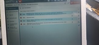

I have one speedster 150 boat and I put a 4tec supercharger with the computer from jetsky wish is the same engine come with the boat but not star ,the scanner say have bad communication with the boat controller. What I should do ?

For most years of seadoos, the ECU has to be flashed for the correct year and model and then married to the cluster for it to run. Typically it will crank but not start so it sounds like you have a communication problem between your different modules.
