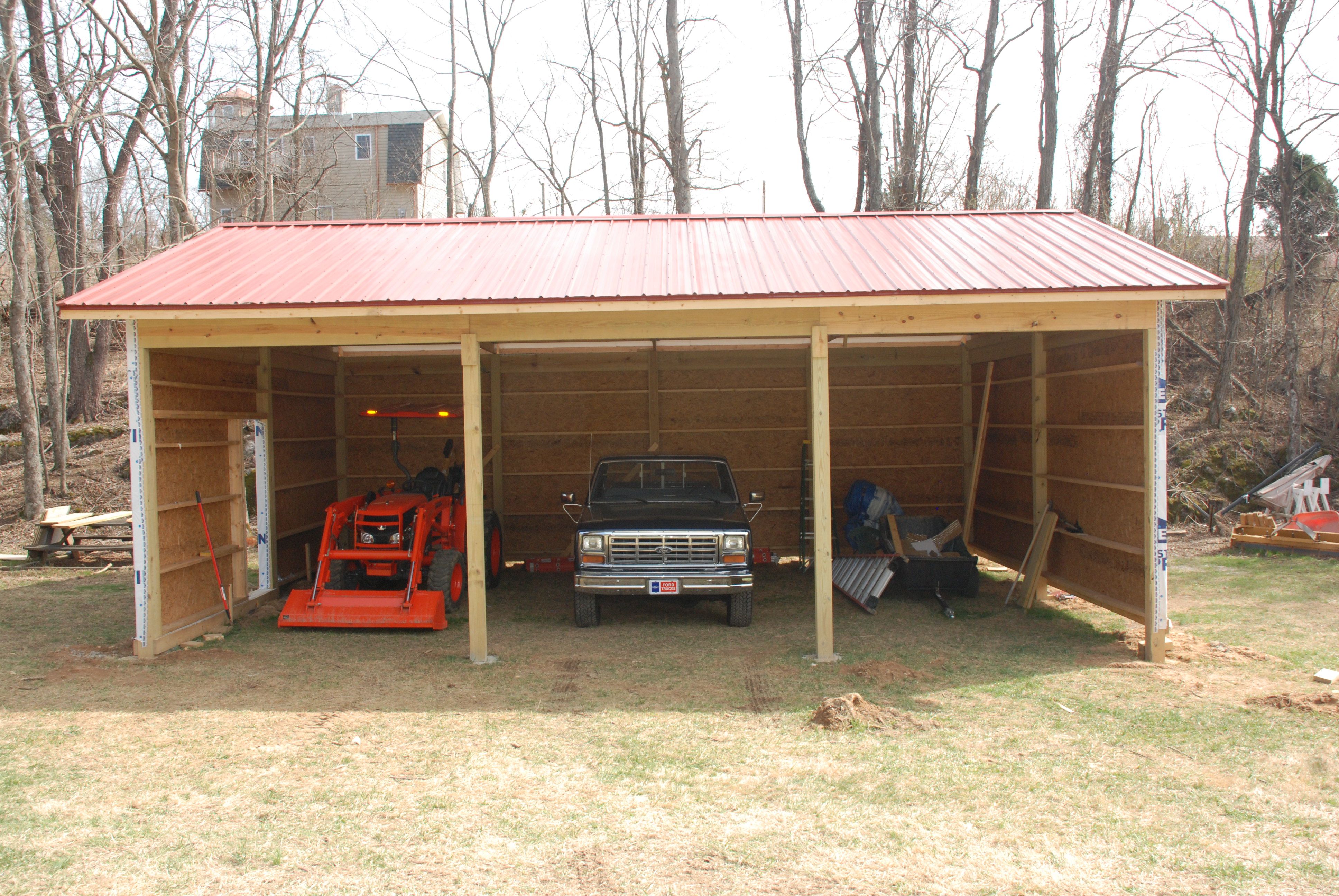

room on the property for another building?
my cousin had a haybarn style building for dirt bikes down in sarasota, worked quite well. short ceilings like 8 feet, it was more labor than materials.
basically a shorter 300 sq foot version of this with a less fancy roof, carport style.
