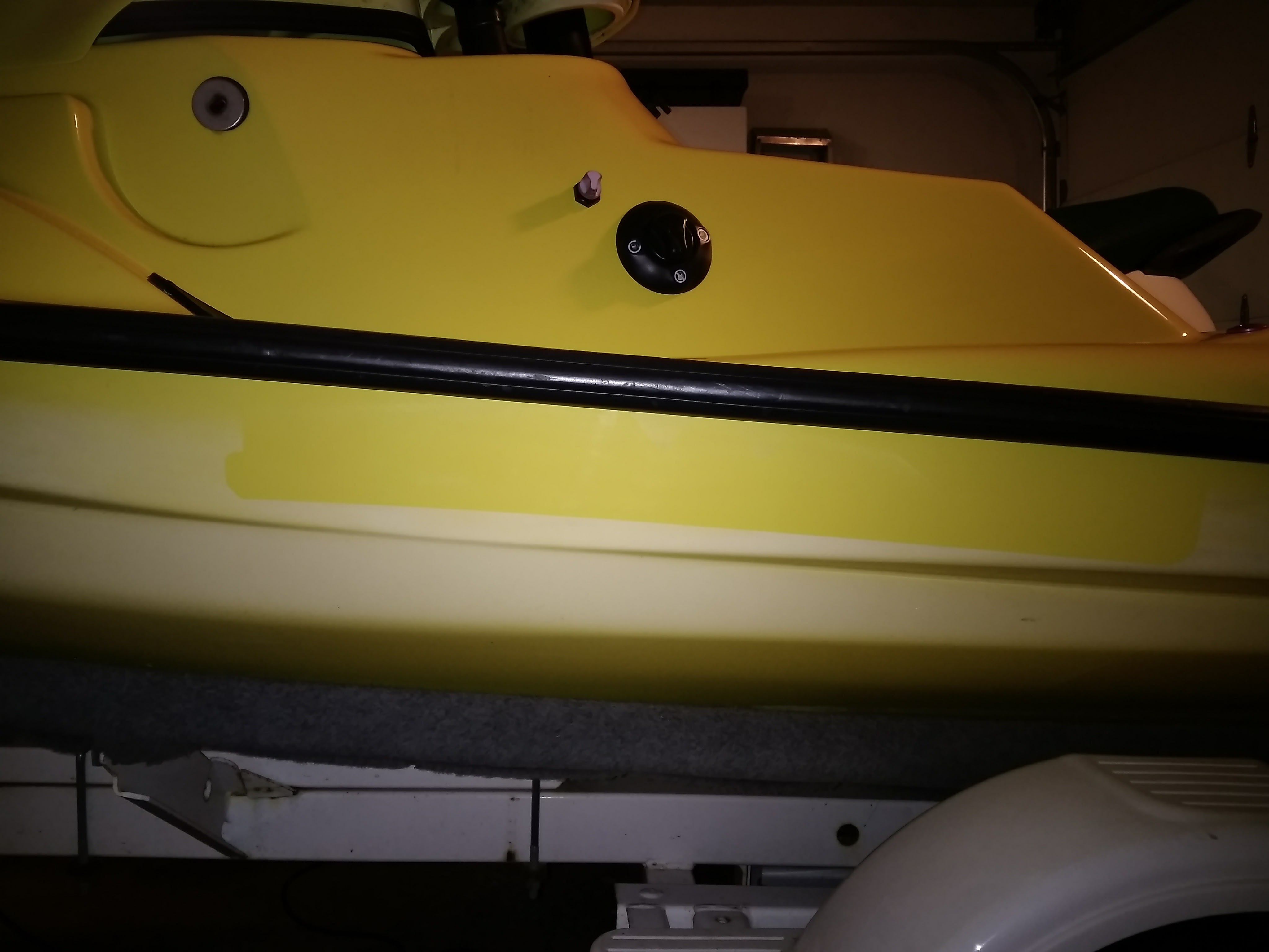

I got one side of the skis done wet sanding. There is no longer any signs of the faded area around the removed decals. I worked all the way up to 2000 grit from 600. Once I get the other side done I will attempt the JSG buffing/polishing method again. I did burn through the lower hood but now I have a reason to paint it black or wrap it. I ultimately want the ski to be black and red with some carbon fiber pieces.
I wanted to share some of the photos I took to show the bad and the good of the ski.

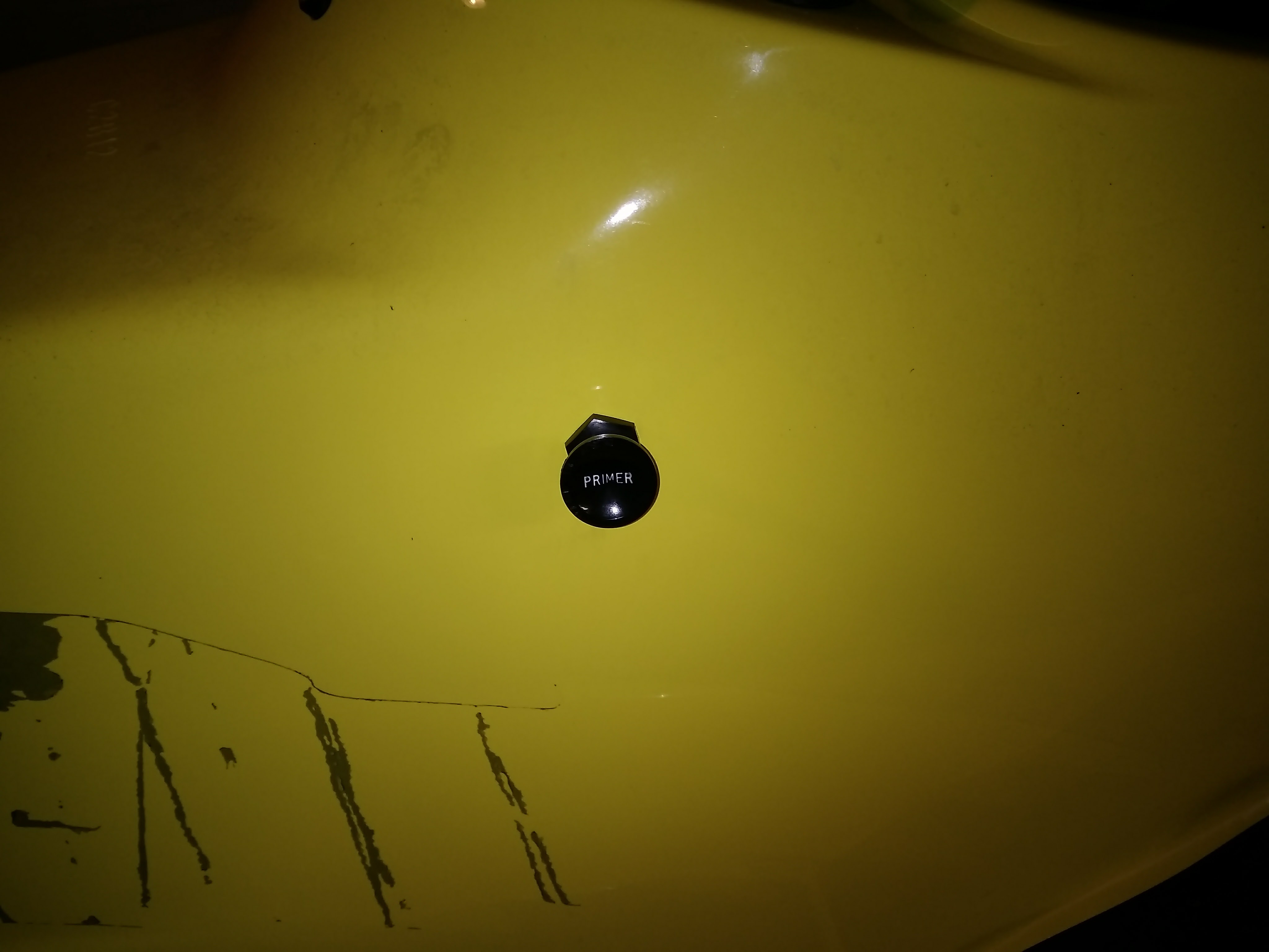

Primer that was added to the side of the ski instead of replacing the OEM one.

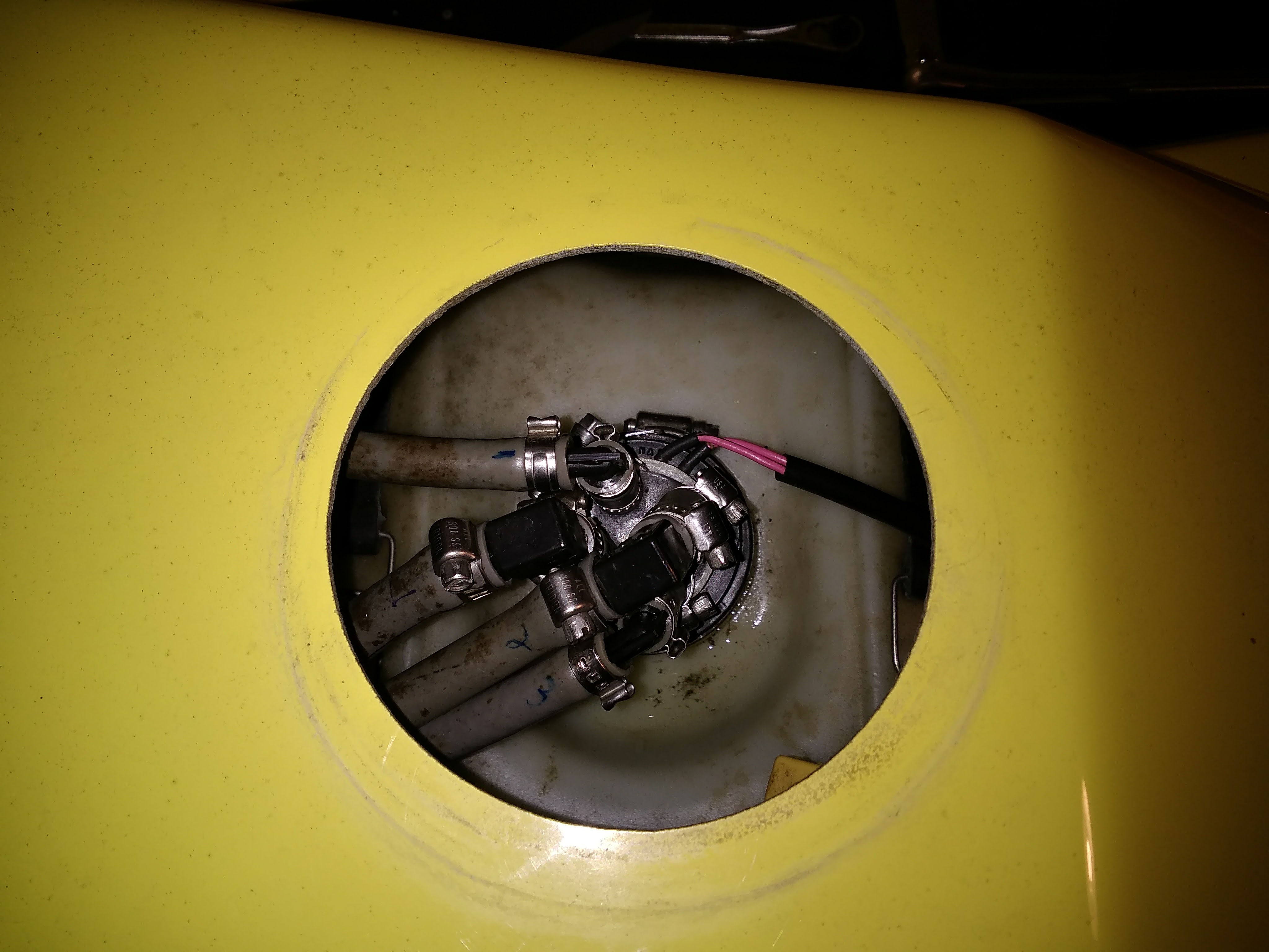

Grey fuel lines that are getting replaced

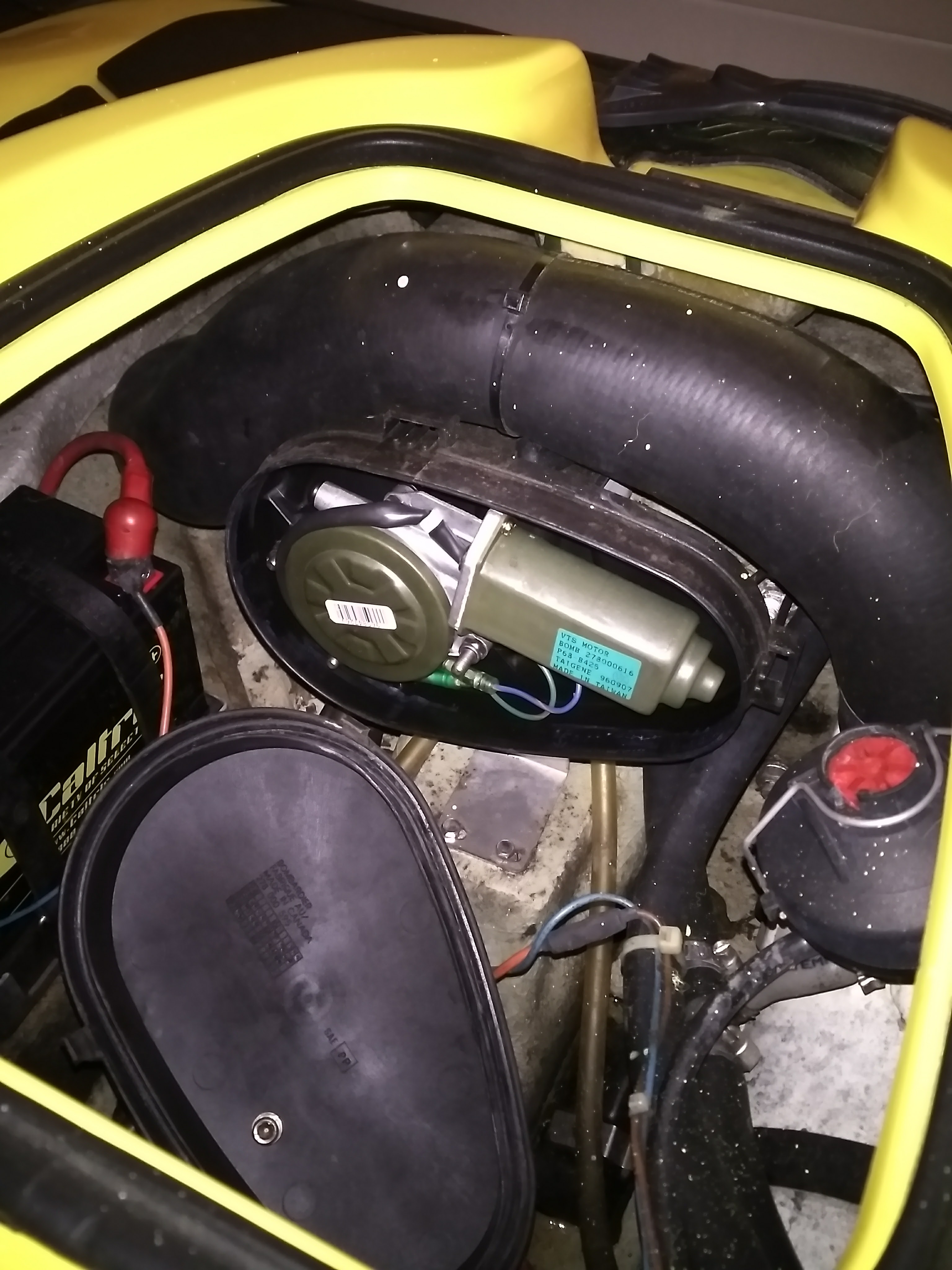

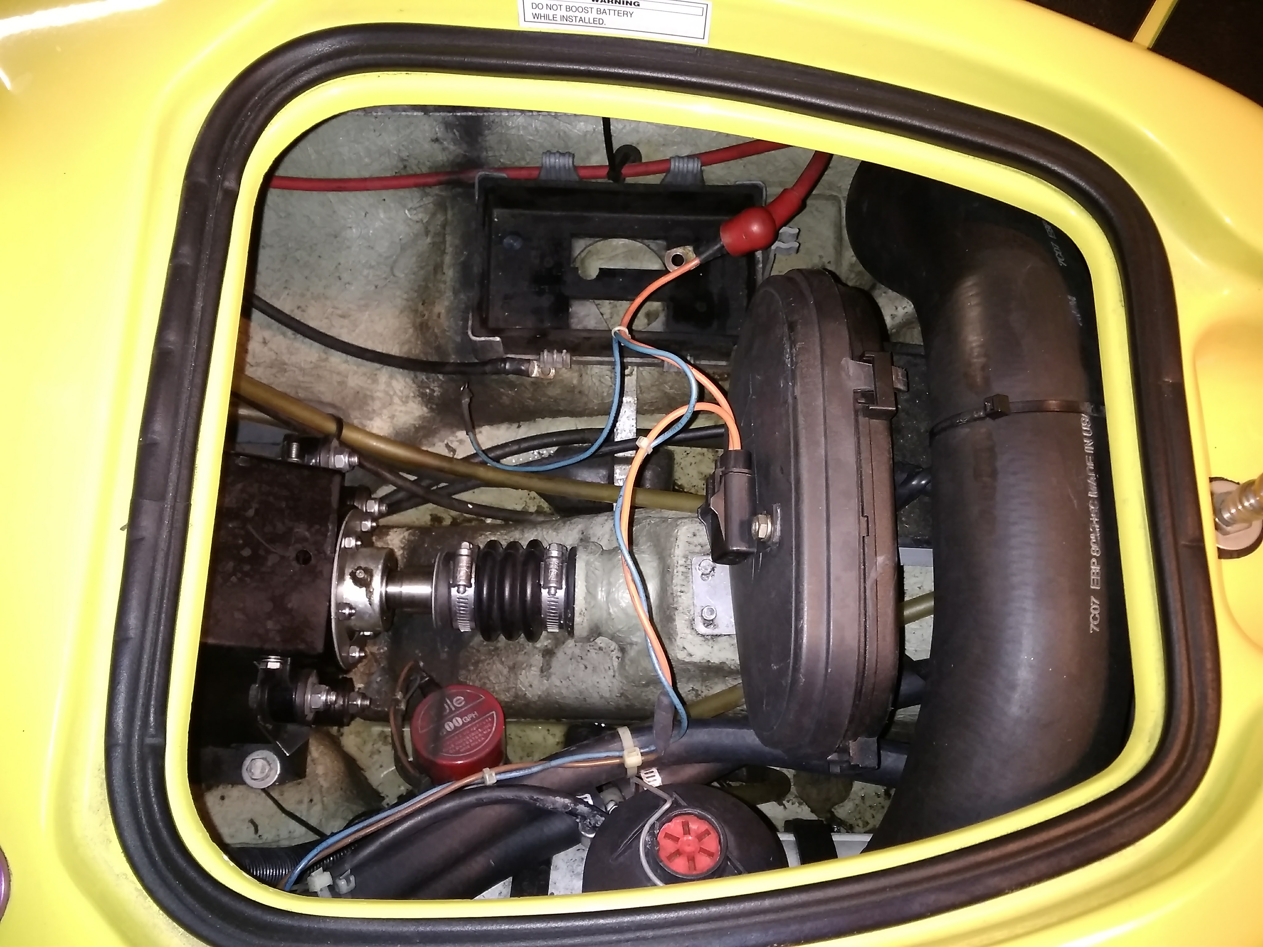

The VTS motor (The electrical box looks just as nice inside)
So I was happy to open the VTS cover and see that the motor looked so good. But one of the clips on the box is broken and there is the bilge pump wiring mounted to the cover. So I think I am going to get a new cover for the VTS motor as well as getting the new boot and plastic clamps. When I opened up the electrical box I was also pleasantly surprised at how nice and corrosion free it was in there as well. I am planning on taking out the rave valves and giving them a clean as well. I found out that $30 for the pair to replace the gasket, o-ring, and bellow. I started realizing how expensive these things are to maintain. I have 2 skis that need practically the same things done before they hit the water. I just don't know what the PO did before I got them and thanks to you guys I am getting a list together.

Change grey fuel lines with automotive fuel line - Getting them tomorrow

So I got all of my fuel lines replaced on the XP today with the Napa non fuel injection fuel lines. I did not realize their were 5/16 fuel lines as well so I had to make a trip up to Napa. I also only used around 13' of 1/4 and about 4' of the 5/16. I didn't really notice any green goo except for a small bit around the throttle bodies and fuel selector. But everything looked really clean and all the filters were clean and even the fuel selector was relatively clean. I really just did a quick clean of everything and put it all back together. It still runs like a champ just like before the fuel line swap. I am not doing any of this on the GTX except for checking the filters since it does not have the tempo lines. Compression check on the XP showed 152/153 and 154/156 on the GTX. So what left on my to do list is below.

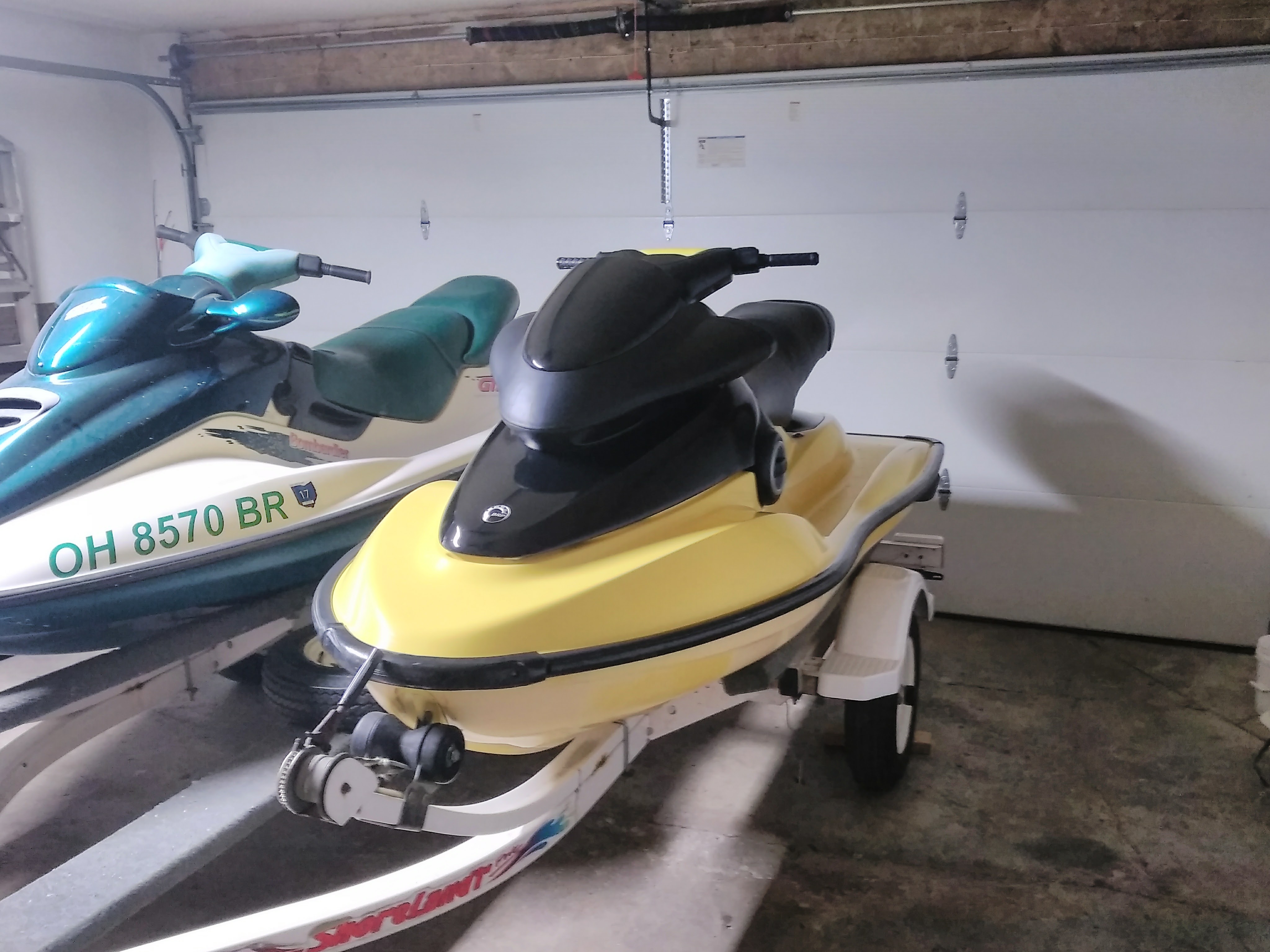

So I completed my list finally and finished up the XP. It has been fully buffed, polished, and waxed. The hood, upper hood lid, and rear hatch have all been painted black. I put all the new stuff on like badge, grips, buttons, VTS cover inside the ski, and the VTS cover with updated clamps on the back of the ski. All fluids have been changed and filters replaced or cleaned. It is put back together and just about ready to go. I just need to get new registration numbers and traction mats. I will post up pictures on the next nice day since I just finished it tonight. Here is the completed list.
Compression test - X
Change grey fuel lines with automotive fuel line - X
Rebuild carbs with genuine Mikuni parts - X
Change the oil filters - X
Replace the fuel valves and strainers - X
Verify API-TC full synthetic oil - X
Change the small 3/32" oil injection lines - X
Change the jet pump oil - X
Grease the driveshafts/PTO - X
Rave Valve clean - X
Plus my beepers are not beeping in either ski but the gauges work and they start. Will I need to replace the beepers.
Here are some crappy cell phone pics that I snapped last night in the garage. You can still see that shine and get an idea of all the work done.
