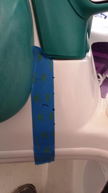

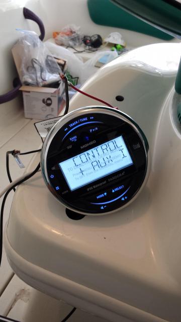

Decided I was tired of listening to just wind while out on the water, and installed a Dual 3 inch head unit with 2 6 inch Dual speakers. The head unit is rated 240 watts and draws 0 amps when off. Another issue that bothered me was the mounting locations everyone was using. I decided to relocate items as needed until I was happy with something that worked for me. The current location allows not me but my passengers to access the unit with ease. The stereo runs off a second deep cycle battery and after 30 mins of run time pulled .05v, pretty impressive. Lastly, I needed it to be easily removable as my boat sits in a public storage area. Yes, its in a gated area but you never know who is coming in and out of those lots. Enjoy!

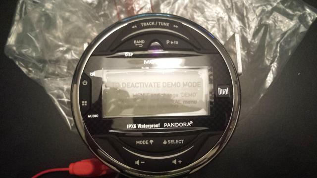

$100 Dual Radio ordered from Ebay

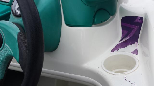

Location chosen for the radio.
Where the DSS is being relocated to.

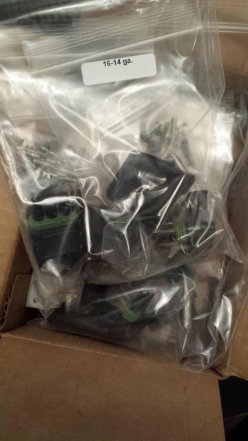

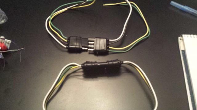

Orginally was going to do trailer connections for the quick disconnect but decided against it.

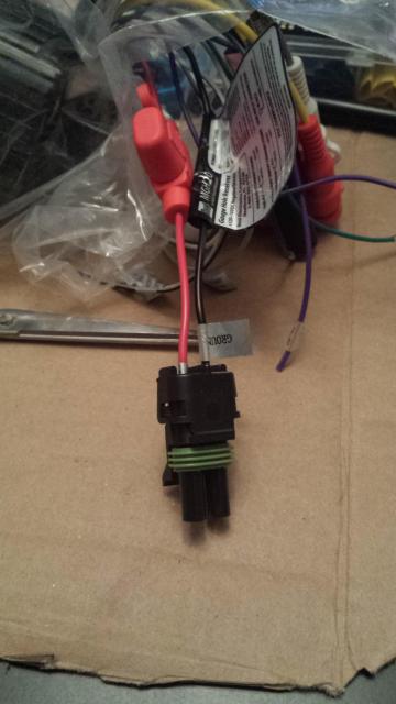

Used Delphi weather connections instead, much easier to work with.

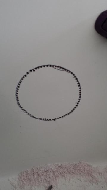

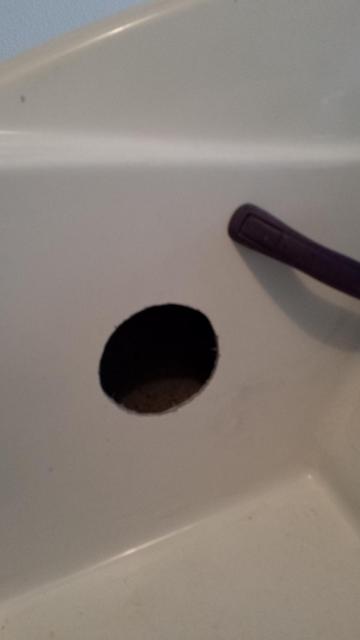

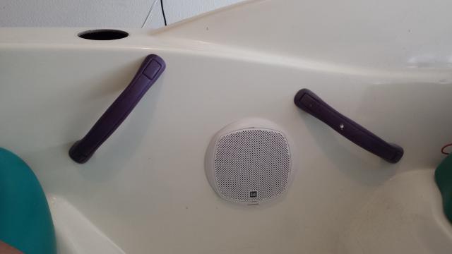

I found using a small drill bit was easiest to cut out the 6 inch holes, my dremel didn't like the fiberglass at all. But was good for smoothing and getting the hole matched precisely.

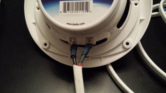

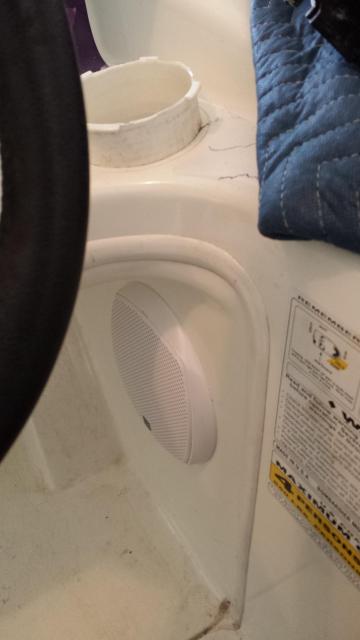

Speakers wired up and weather proofed.
Port side installed
Stbd Side

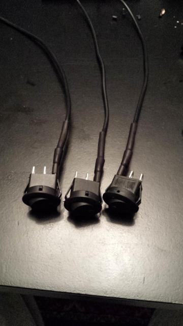

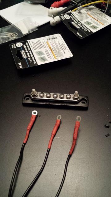

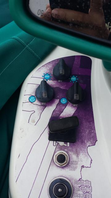

Bus bar for the new LED rocker switches, replaced those ugly turn knobs.
Location for the LED rockers, notice there are now 4 switches. Decided to run the Nav and Moored lights separately.
Port side installed
Stbd Side
