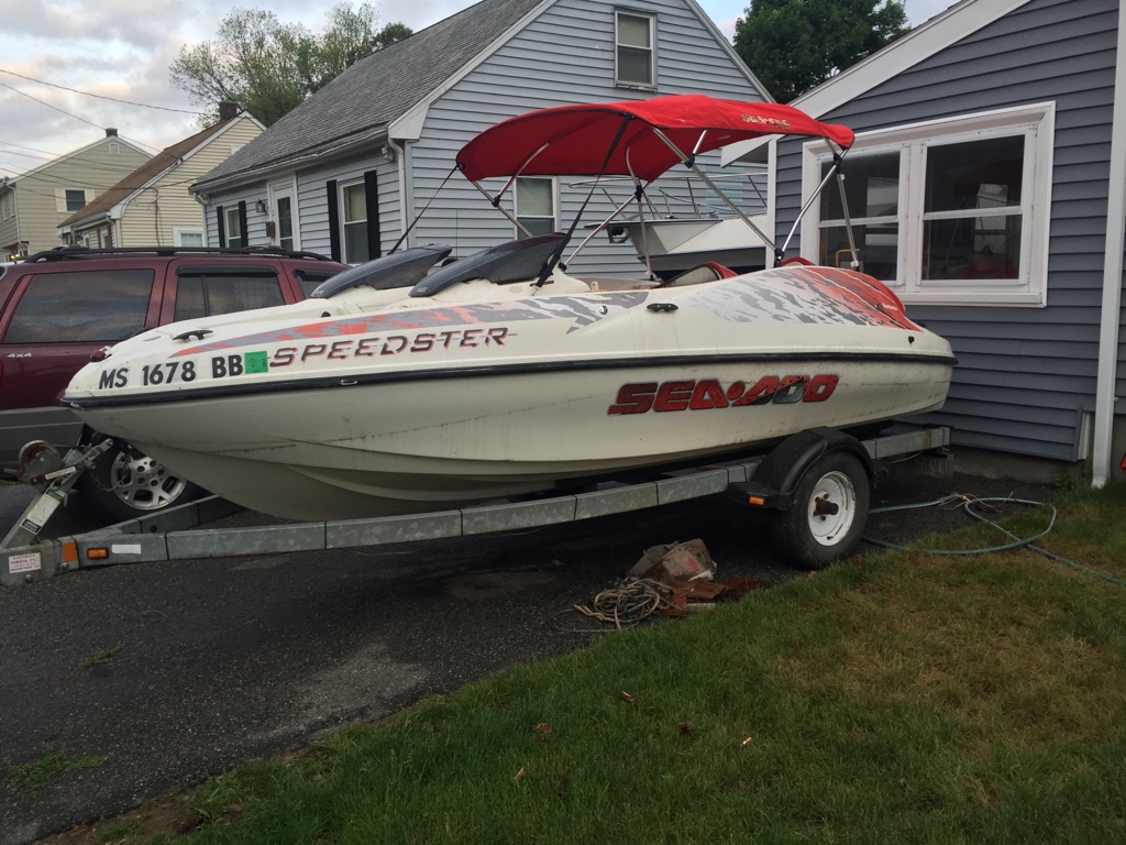

Here is the boat!

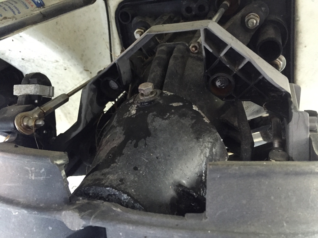

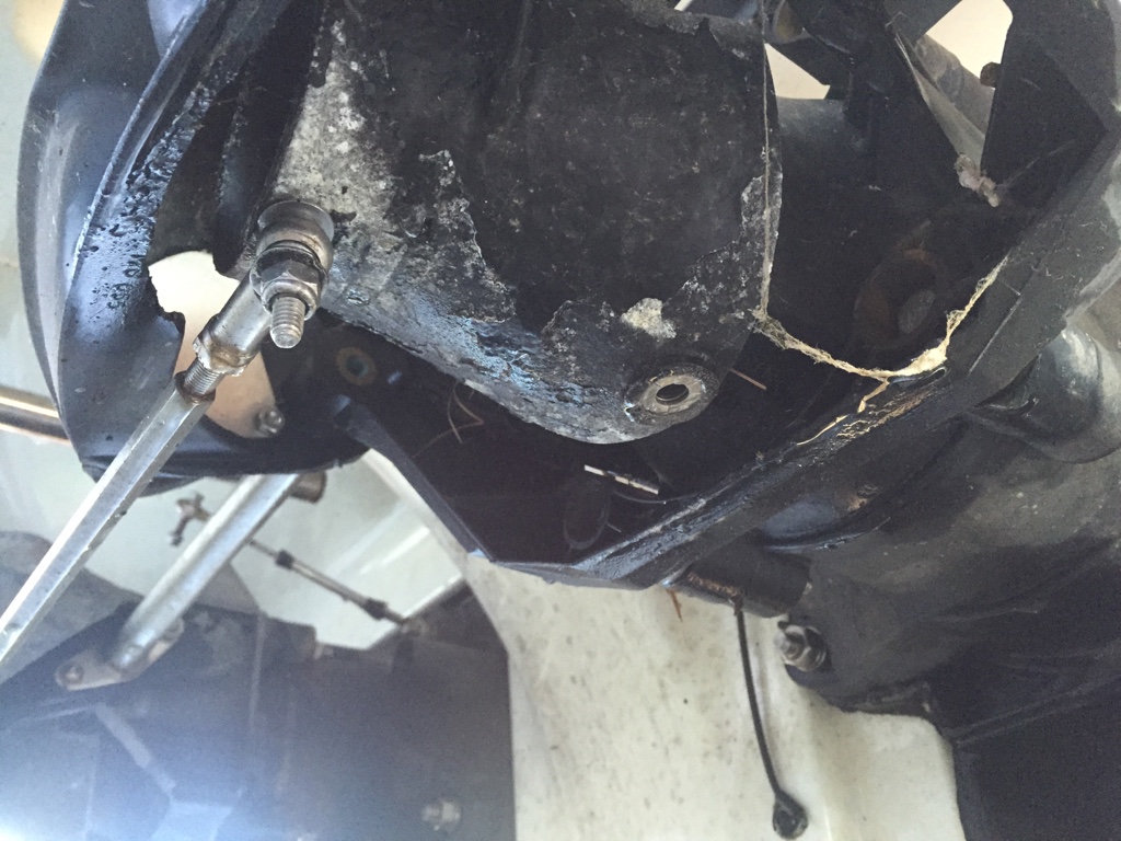

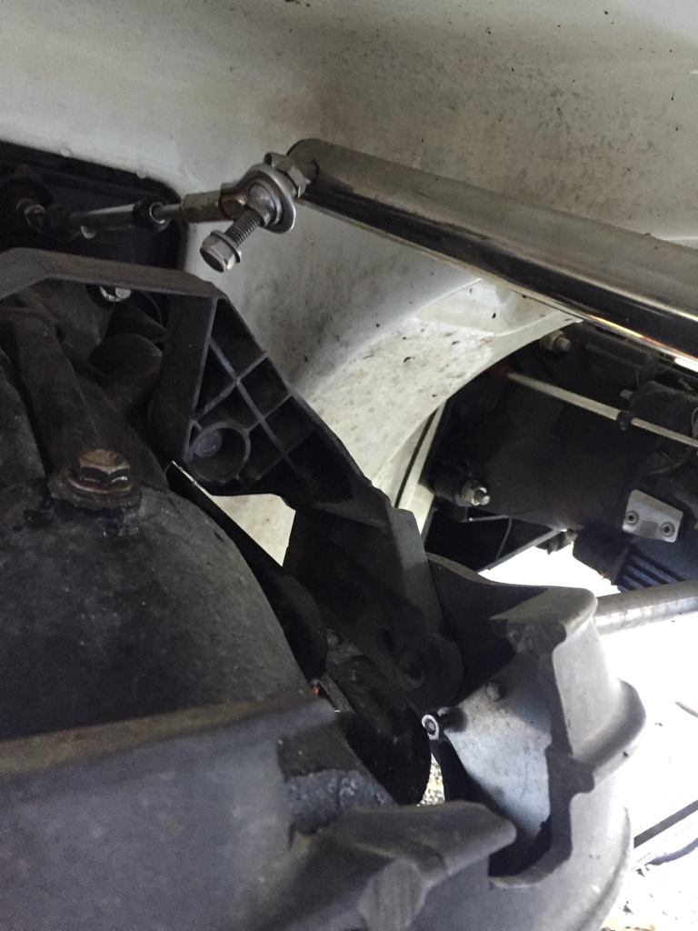

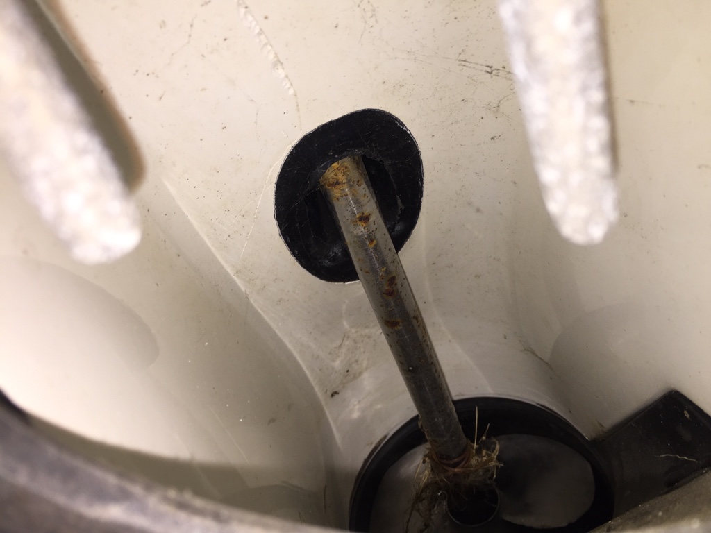

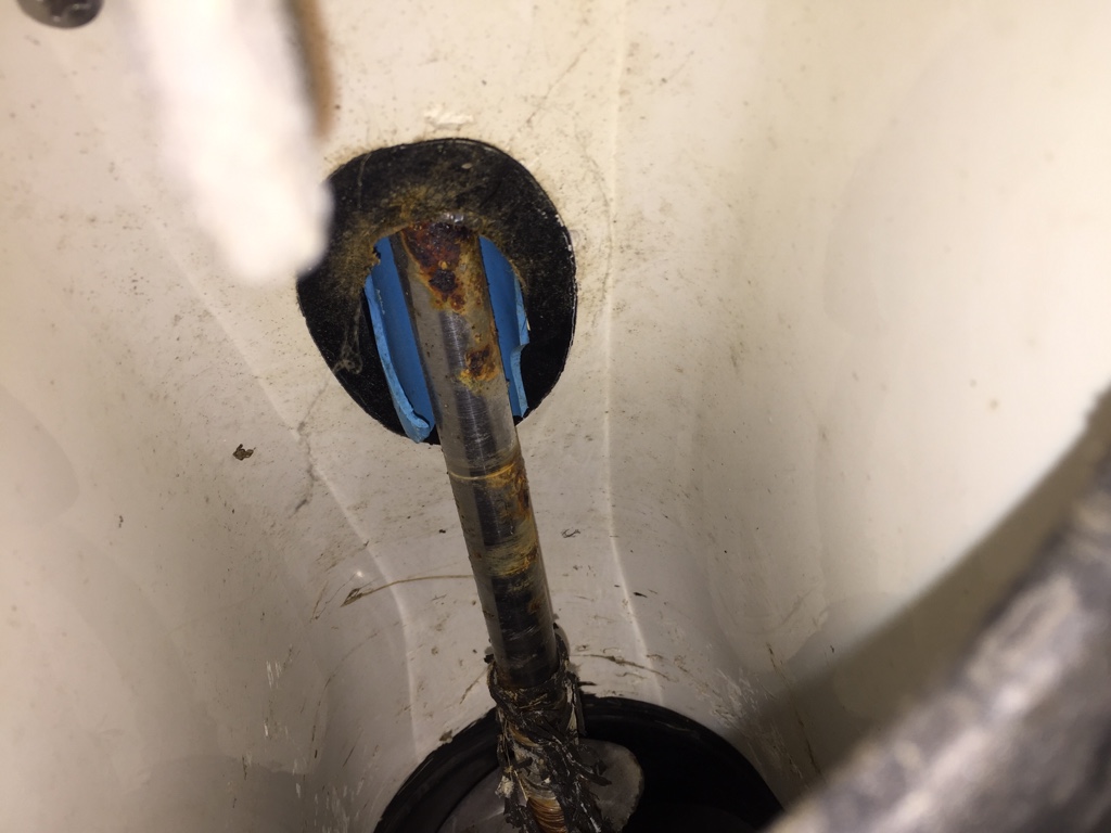

These linkages are the ones disconnected they were suppose to be connected to the shroud that provides reverse thrust but it looks like it has been modified.

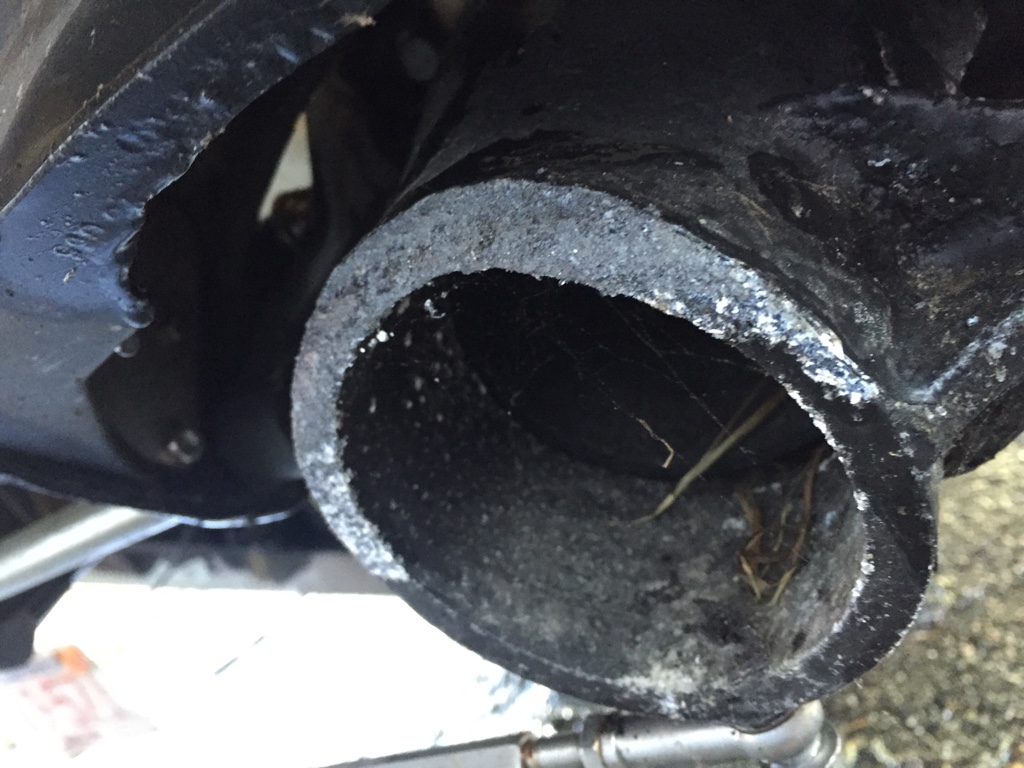

[MENTION=57920]racerxxx[/MENTION] you were correct about the exhaust boots they were rotted and covered in silicone.

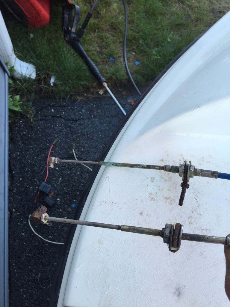

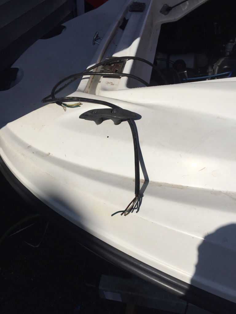

As for the "trailer" wire
It was fro trim tabs somebody began to fit up but ultimately couldn't fit on the transom

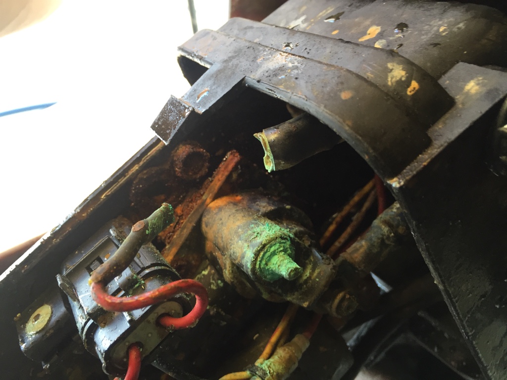

OMG, I don't even know where to begin on whats wrong. That trim tab switch, LOL, lose that. The cable that is coming out on the port (left side) towards the clam shell, yeah that isn't supposed to be there nor the one on the starboard side in the same place. That was someones hodge-podgery on a variable trim system. I got a feeling that is where the trailer wiring comes into play possibly. There isn't even supposed to be a cable coming out the port side at all. I have a feeling I'm going to be your best friend for pics, LOL.

Now for the big question.......Do you have all the seat cushions? Oh, and those exhaust gaskets I told you about............they're obsolete. Gotta snag them on ebay when they pop up cheap. Some guys try and gouge for $50 to $85 bucks, I won't pay those prices. Other guys have substituted and vent pipe seal like on your roof.
In fortunately my iPhone can't get to the parts pages I'll have to try on a pc tomorrow.

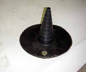

As for the rubber exhaust seal in the trades we call it a "witch hat" one that is meant for a rubber roof membrane will work fantastic!
that will be ideal for that application and I bet it will last longer than the original.
I was planning on eliminating the trim electronics and it is a relief to hear I can eliminate the other linkage whatever it may have been. I will seal t the penetration with marine-tex epoxy from both sides.

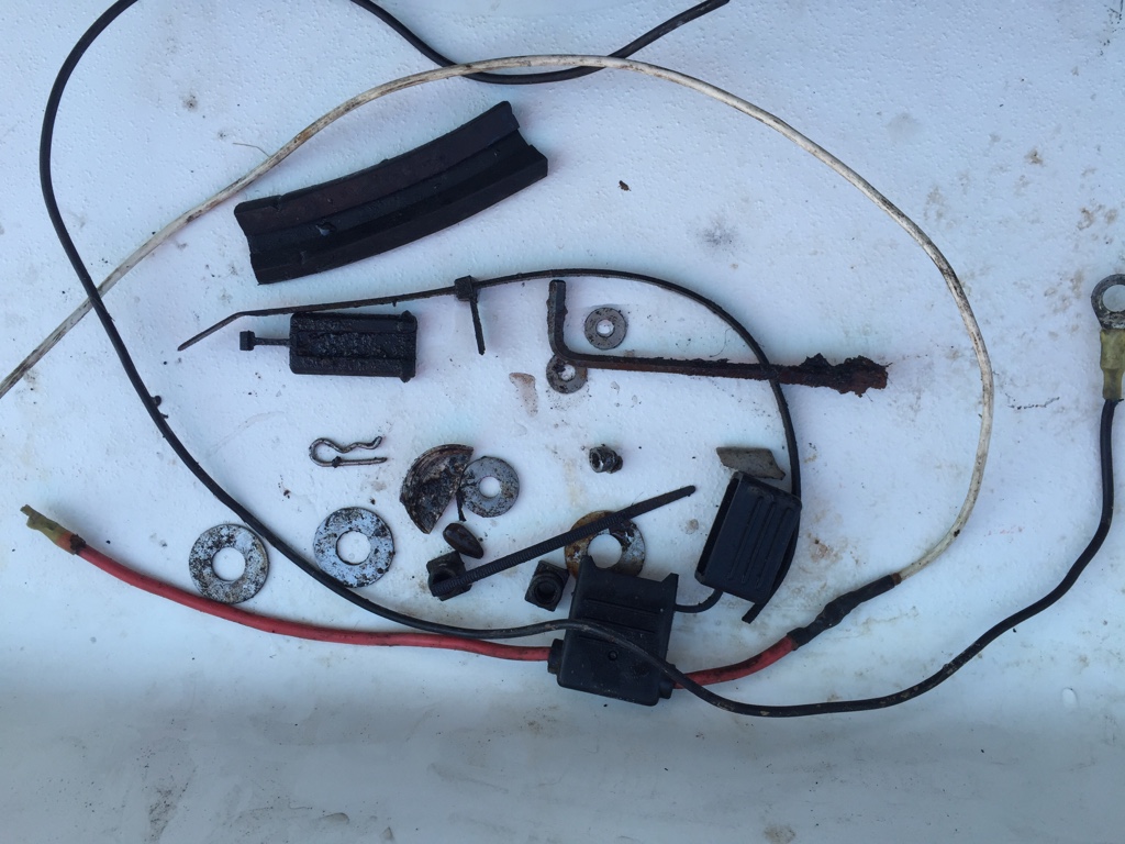

I'll leave you with this
All of the parts I found in the bilge....

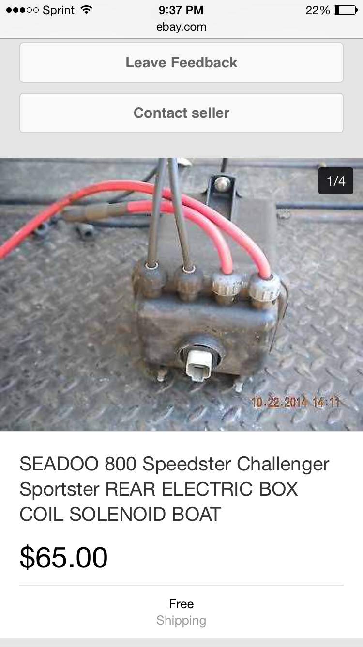

So I was able to do a bit more work today I found one of the ignition wires for the star port engine was chaffed through so I took the starter solenoid from the star port engine and wired up one "electrical box" I then hooked it up to the star port engine and cranked it for a while. I am still getting lots of oil out of the cylinders but I was able to get the engine to kick one time before the plugs got fouled. Thankfully I was able to find a complete setup for the star port engine on eBay for $65 shipped. I also learned that those coil wires are significantly longer.

I was also able to poke around with the defunct trim tab setup. Whoever installed it actually put some serious effort into it I found they had wired indicator LED's above the instruments to show that the trim was bring energized when you depressed the button. If I remember I will upload a photo tomorrow.

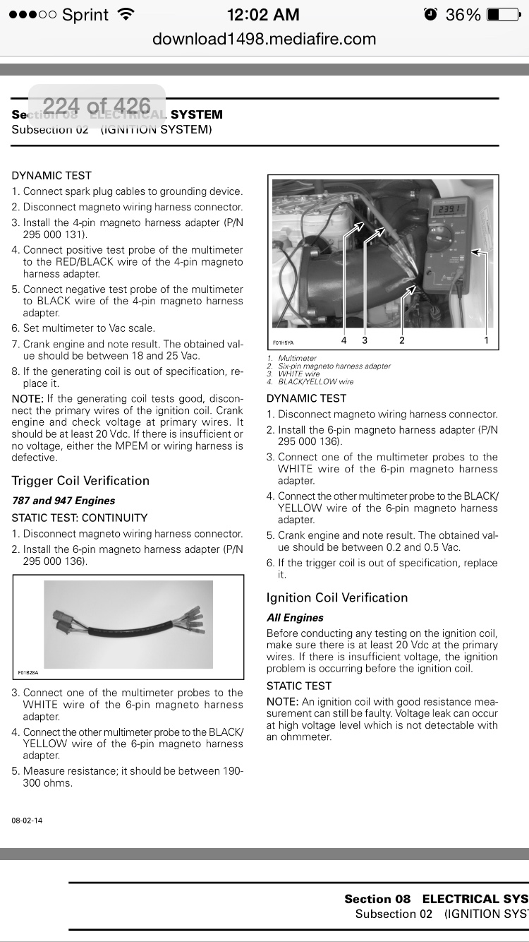

As for the port engine, there is no spark, I get aroximately 180mv dc to the ignition coil on the starboard engine and nothing on the port side. Any ideas?

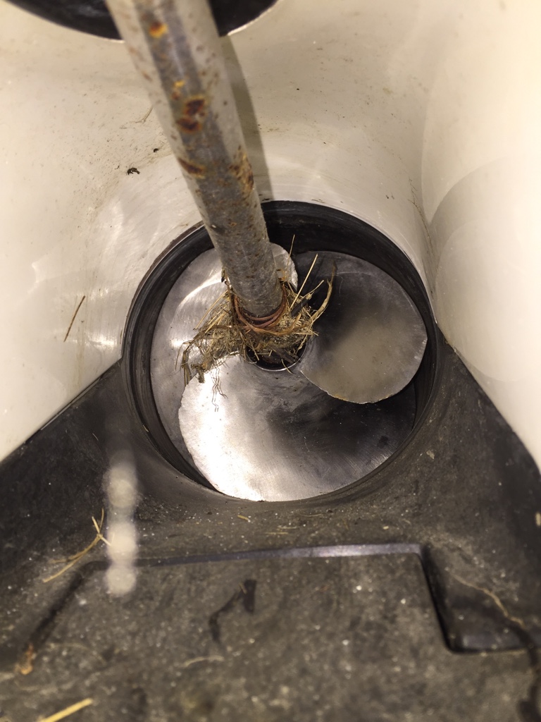

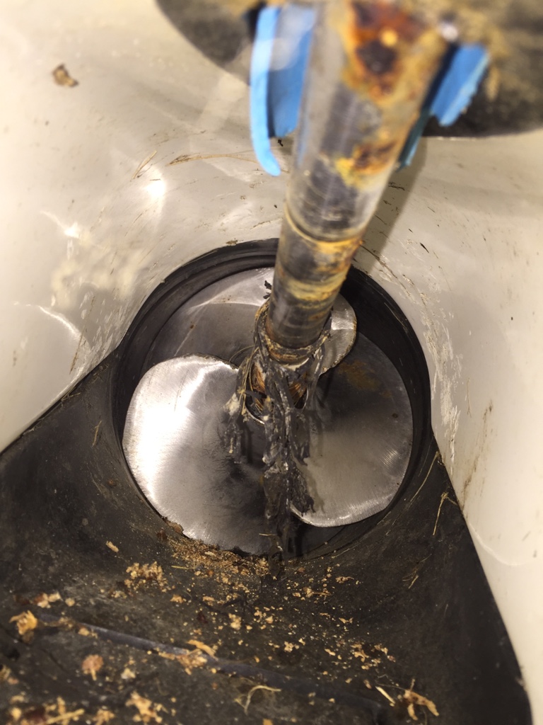

I also got some pics of the pumps from inside the tunnels there appears to be some areas of concern one blue pice of plastic and some exposed glass in particular
I found this testing procedure in the fsm it was for the pwc models not the boat. It appears to be correct for this model though.
I should mention that the the key does not give me any chimes at all. But the starboard motor does run. I hope that it's just a faulty wire

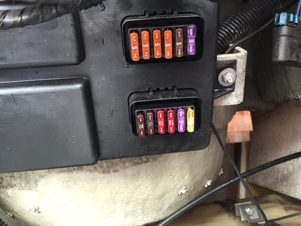

So I found a blown fuse in the mpem and two missing fuses I replaced the 7.5 that was blown and installed two fives where the were none.
Can anyone post a photo of the proper fuses in their locatoins?
