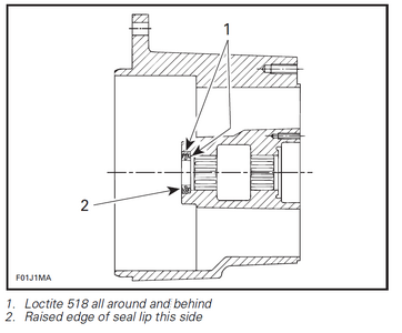

2strokeboy Active Member Jun 6, 2024 #1 What way is the shaft oil seal supposed to go. Is it supposed to be the flat metal side up or down?
B BrianMoore Member Jun 6, 2024 #2 Raised edge of seal out per the manual. I think that makes it flat side of metal in. Use 518 on metal and grease the seal.
