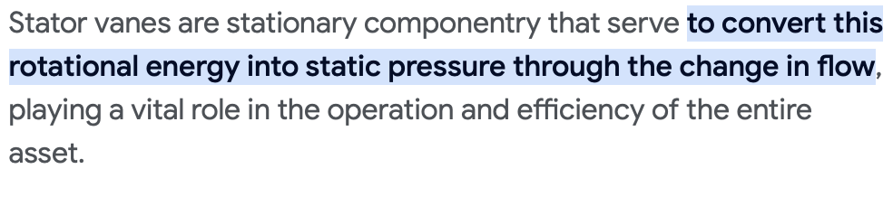

Just a little back story, but I recently purchased a 2007 SeaDoo GTI SE 155 with a 123 hours. Did the oil change/plugs, got it on the lake and found out it had major cavitation issues. So I removed the pump, and the impeller/wear ring were basically destroyed and all of the stator veins had some sort of damage. Replaced it with a Solas 10/18 impeller kit and new wear ring, new pump seal, and replaced the grease on the cone. I also used a dremel tool to sharpen the stator veins, but the gap between the back side of the impeller and the veins is now far more than factory.
