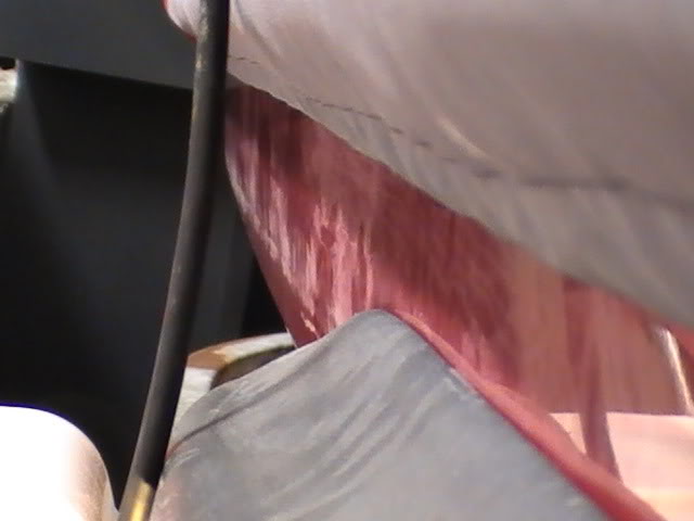

Ok yall. Here is some pic's of the stuff stuck to the side of my ski. It isn't on the other side. Just this side. May be on the bottom too. I'll have to look. What do you think it is and will this stuff yall told me about work? I don't want to mess up the finish. I want to wash and wax it this weekend. The battery went dead also. I have to buy a battery charger for it and the cars.

COOL! Thanks snipe. Sorry they are so blurry. I hope that gave you an idea of what is on my hull. What I don't understand is why only on one side. I need to check the bottom. Do I need to clean it first then after. Or what?
water line?...
Kinda weird that it's only on one side. It may have come from the wash of the tide, only to one side. Or if it were at dock, just to that side.
The pix are kinda blurry so I can't tell what it is. Usually, it' something dark, like an oily substance floating on the water. Seems its going to be localized to the water line. The bottom is probably going to be clean.
maybe sun-baked from being parked on driveway. When sun up, cant hit other side of boat, or vise versa, being blocked from house roofs, trees,..etc

To me that looks like damaged/weathered gel coat. Since you say it is on one side it makes me believe it is from sitting in the sun. If you haven't began using hull cleaner I would hold off on that for a little bit cause you will only cause more damage.
Does it have a dry powdery feel? How does it look when the ski is wet? If it looks better it is defn damaged gel coat. There are lots of gel coat treatments/conditioners out there that would make it look almost new. Once you treat the gel coat and coat of wax will make it look good as new.

hey matt...what you have in mind, boat I just picked up, looks like sun beaten. Havn't tried anything yet, but gonna tackle tomorrow. Got me hesitant though, with causing more damage if it is sun-bake and not salt-water...
I used a few different meguiars products. First I washed with the Oxidation remover (they have too...a mild and a heavy duty one, the mild did it for me) and then washed with the premium boat wash...any boat wash will do I am sure. I finished this up with the meguiars polish and their marine paste wax. This did an amazing job...looked just like new and this was on a maroon ski.

I found the Star Brite stuff at Academy. I got the hull cleaner stuff snipe was talking about and some Star Brite polish with PTFE in it. It said it was to recondition gelcoats. Plus it made it very slick. Should I wax it now? I also bought some vynal restorer for the seats, rubber and plastic. Turned out great. I have some scratches on the bottom. Some I can see Fiberglass through. About 1/2" side and 1' long. Will I need to fix these? About how much will it be to fix?

alright, been at boat for awhile, and seems to get better, but still has a whitish look. The boats green, and when using stuff, my apllicator pad turns green, let stuff sit-up, then wipe, still whitish. Think it has serious sun cancer. From what DCKD mentions, leaning on using the Maguires, rather than "hull cleaner'. Was goin right now, for "Starbrite", but dont think its "crud" on it. What you guys think?
