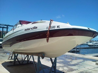

I am one lucky lady! Look what I found! 2004 Islandia
SeptemberC
Lucky lady found 2004 Islandia 240EFI
It does need some repairs. Here are some of them. If anyone has parts or suggestions on how to repair please feel free to post them.
I know I need an intake grate. It still has the weedless. The gas gauge works. The speedo, tach and stereo do not work. The ski locker is missing a hinge and it looks like the fiberglass on the locker door itself is cracked. The rear ladder door is completely off mad the ladder itself is no longer attached. The bilge pump does not work. There are a few places in the hull from where it was put on and off the rack that needs repair. Nothing structural. Just cosmetic. The engine will need routine service come spring time.
I'd like to find front and side curtains for the Bimini but I know those are a long shot. And of course I need an extended ride plate from Aquaman or I could take the one off of my challenger. But I figure that when it sell it this spring the new owners would appreciate it as much as we did.
My dad has already bought me all new chrome cleats for Christmas!
I also need a box of magic erasers to clean a little rust from all of the other chrome/metal pieces. It'll have her looking new and shiny come spring!
I will also be selling my 2000 Challenger 1800. I wish I could keep them both!!
The fountain pump works, the sink works.
The
S/N 0E374776

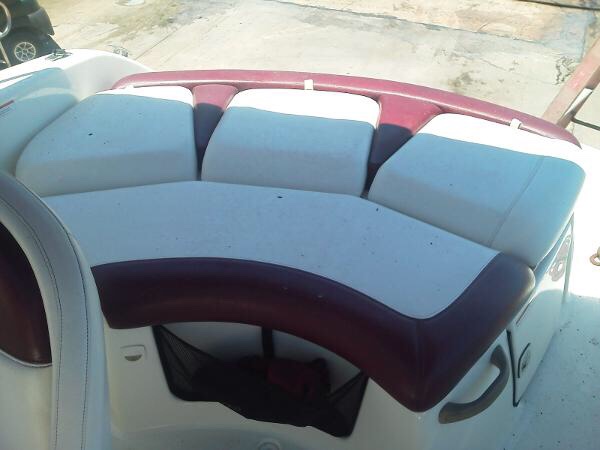

Dr Honda, the picture of the seat support. The small bracket has been bent and the holes stretched. What would you recommend for the repair?
Great idea on the gas cap key. I'll order another one and that should make it much easier and make me feel better. Are all Deck Keys the same? Space between the lugs?
I am a Lake & River kinda gal. The weedless grate would suck and catch plastic bags (Walmart bags) and I have heard stories of the tines breaking off the weedless and junking the impeller. The rock grate has never clogged on me.
Yep... that happens, and some people say it's a "Ticking Time Bomb." But, if you keep an eye on it... it's not that bad. A lot of people like the rock grate. It's the safest option, just may clog more depending on where you boat.
If that was my boat, I would simply pound it flat again with a hammer, and then put aluminum washers over the holes, and put in new pop-rivets. (it's common to back a rivet with an aluminum washer) There's no reason that should be broken. Someone was being rough (or drunk) with it.
