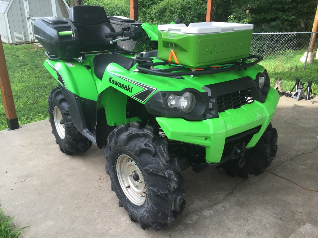

It looks like this, but this one is missing the lime green beer cooler on the front.

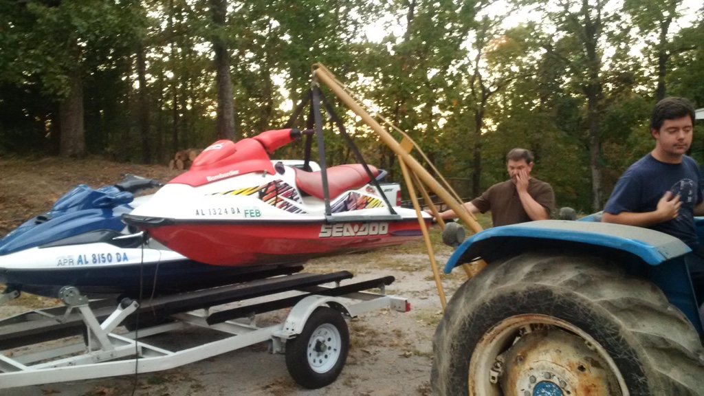

Unfortunately, my favorite lifting device doesn't live at the house. But it does work well!

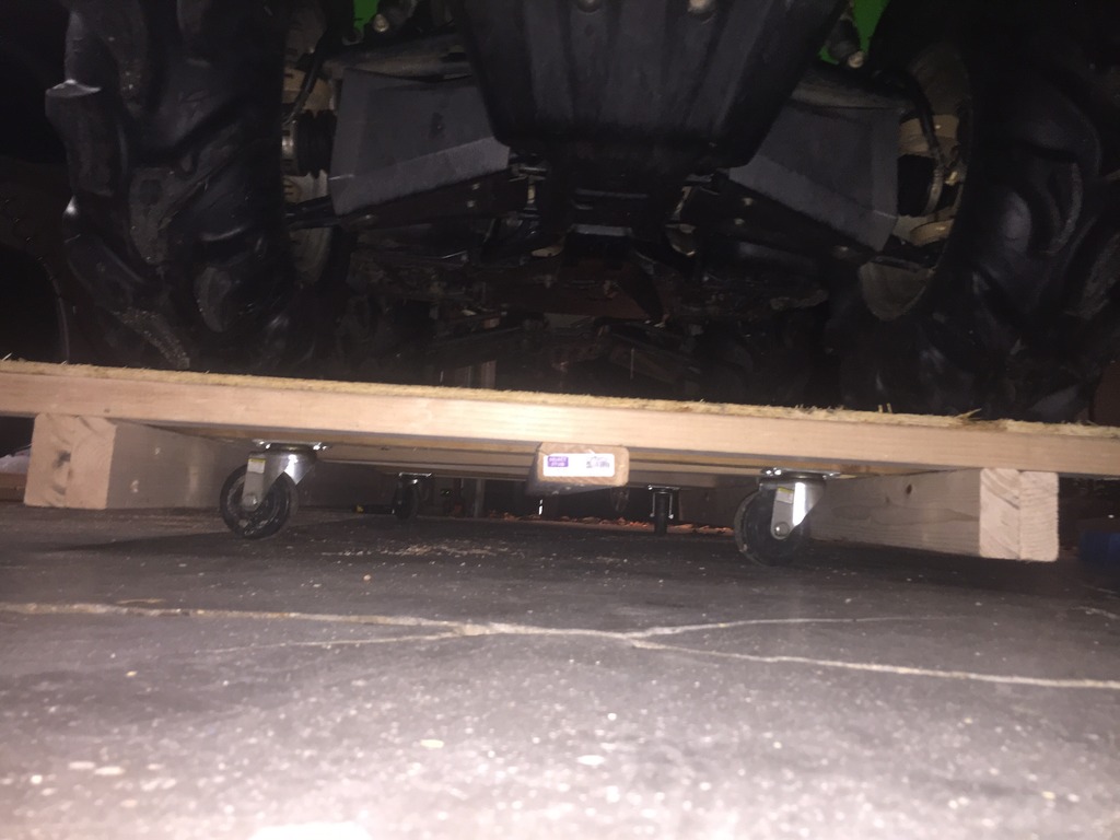

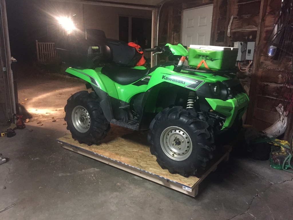

Got it all done tonight. took about two hours and about 7 2x4's. Moves around awesome, just like the pwc carts. Just drive right on it and go. This will be the cats meow this winter when I put the plow on. I have been playing parallel park in the little spot and then literally dragging the ass end 90 degrees when I wanted to take it out. Thanks for the reminder guys. Lots of cool things we can do with these carts.
