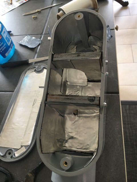

1. Attach the 3in TA (2) over the in let of the 2 1/2 LB (1) with the Cement (3) and let set.
2. Open the 2 1/2 PVC LB (1) and line both the lid and the inside body with the peel and seal (5)
3. The LB (1) should be lined along with both holes
4. Paint the LB (1) to match the boat "this is just to make it look factory in the engine bay"
5. Remove the air exhaust port cover from the boat
6. Move around wire harness and insert your new silencer into place up through the hole and start lock nut (4)
7. Turn your new Silencer clockwise until it hits the hull of the boat
8. Carefully tighten the lock nut (4) until it is firmly in place. "i used a punch and rubber mallet and made little taps" and re-install air exhaust port cover

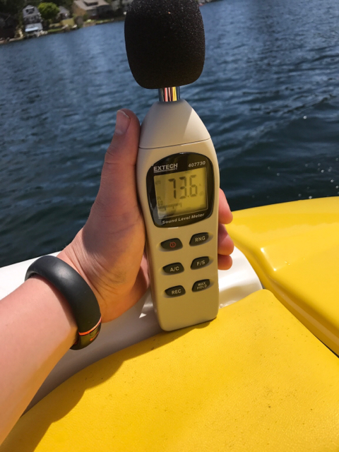

This is a before and after Db test taken out of water with both engine running. Sound meter set to max hold/slow for the best results. These numbers are the highs at 2,500 RPM
6db difference is a big deal! But seeing it out of water. WOW

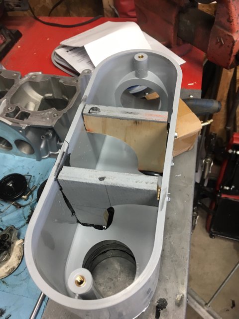

I was able to find the box at an electrical store. I decided to make some separator inside.
I'm not good at wrapping !
Looks good! What size LB is that?

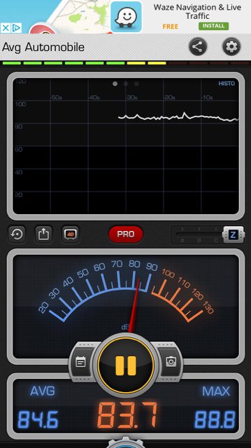

Let me know when you do a water test and how it worked. (Do you have a sound meter?)
You can download an app on your phone to get some idea. I'm sure it's not real accurate bit will give some way to gauge the change.
