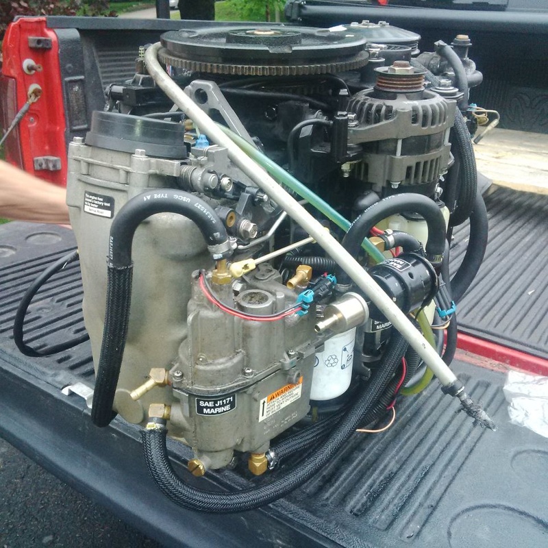

Well I think I may have found it, I won't know until next week... I finally had some time to examine the engine and lo and behold I found a bolt and washer just sitting on top of one of the engine component housings. If you look at this photo:
The large piece with the part sticker SAE J1171 MARINE on it... it's bolted to the engine with a bolt towards the top. That bolt somehow came complete off and was sitting on top of that part in a grooved channel meant to allow you to screw in the bolt and fit a socket in. The entire thing was loose... So I highly suspect that bolt happen to pop off and with enough engine vibration, it was rattling violently in that rounded space. Not sure what exactly this part is... I see the water separator attaches to the side of it. Anyhow, I think this may be the culprit.
I checked the compressor and there's no movement on the pulley when I pull on the belt. I'm told if the bearings are going, you see movement.

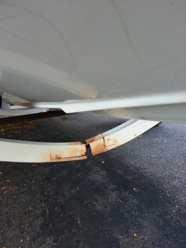

More bad news though... as I said this was my first week with the boat at my place and first time out. I get home, park it in my driveway and that's when I notice the front cross-member of the trailer has completely broken in half :o *sigh*
