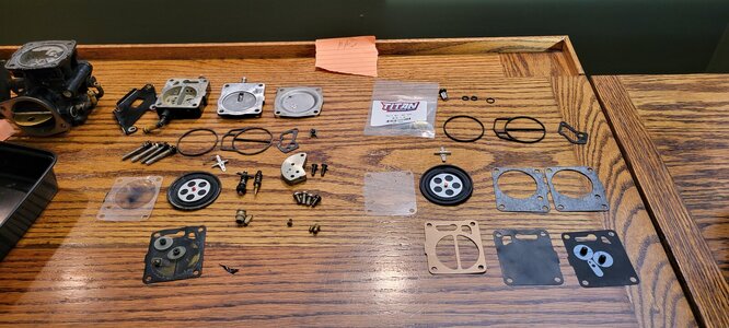

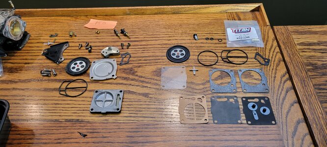

  4. For the MAG side, does it use ALL diaphrams/gaskets? There are three cardboard-like gaskets, I know I use the one that is tan/brown as it is the one I had to spend an hour scraping/sanding off the block. I know I use the two thin black gaskets as well as the clear one (and the small circular ones). The kit also has two grey-ish looking gaskets, do these get used? Pics attached for reference20230606_215753.jpg20230606_220920.jpg
Sorry for the bad news but that Titan kit is not OEM Mikuni so you are going to have the reorder all the parts and they have to be Genuine Mikuni.
Then all your questions will be answered here in the Carb Rebuild Thread. The Seadoo Carb Rebuild Thread
Also make sure you get the new correct pop-off spring and new needles and seats.
The kit itself IS Mikuni (one for each carb). The Titan bag is supposed to have Mikuni Needle/Seat in it....but I will double check to be sure it really is.
Edit: The Titan bag does NOT contain the Mikuni brand needle/seat, so I will be returning.
My goodness it was hard finding the Mikuni brand needle/seats. Everyone tries to trick you by throwing their name around....this is why I ended up w/ the Titan brand. In any event, the Mukini brand is on the way.

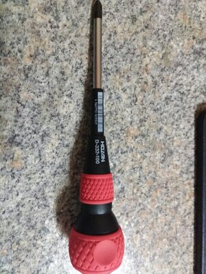

Either use a Japanese Industry Standard JIS Screwdriver or an American Impact Driver Phillips Bit for the Mikuni Carb Screws. Anything else will strip the Screw Heads.
American Phillips Screw Tips are designed to cam-out at a certain torque. The JIS are designed to seat deep and tight. Has to do with different mass assembly philosophies. So the Screw Slot angles and depth are different.
The American way, the Assembler would just torque the Screws till the Driver slipped; that's how they knew the screw was set.
The Japanese relied on the Assembler or a Torque Limiter. Once the correct tightness or torque was reached, the screw was set.
Vessel makes good JIS Drivers. Buy yourself a Set. You can buy a new Carb Stainless Screw Kit on Ebay
Mikuni Carb Stainless Screw Kit Super BN SBN 38 44 46 Seadoo Sea doo XP SPX GTX | eBay
This site contains eBay affiliate links for which Sea-Doo Forum may be compensated.

I have a JIS screwdriver. The screw hole in question I came to find out had the remnants of an old screw in it (from whoever messed w/ these last)...popped out when I was drilling it to re-tap. I went the next size up and I think I am good to go. As for the small screw on the check valve, if I was the one who did it, it was because my JIS screwdriver was too big, but I didn't see a dimple so not sure if it even is JIS? regardless, on the other one I found a small screwdriver that fit better and came right out. What do you use for the jets?? For most of my flat screwdrivers there was some play which led to me stripping the idle jet (and with such a small hole I didn't have many to choose from)...and they were in there pretty damn tight.
