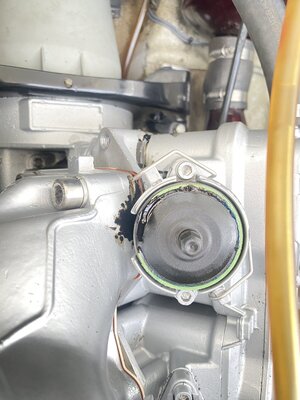

Yesterday when I came home I inspected the engine, and everything was pristine as usual. But today, I go to take it out, start it up and let it warm for a few minutes and start backing away from the dock. I took a quick peek at the engine and there's black oily fluid coming out of the rave from the rubber plunger.
Why would this happen?
Is it common for these to tear or leak?
Is this cause for concern or can I just replace this?
I have been babying this thing, doing the break in to the letter, this should not have happened!
I have had zero running issues, everything is dialed in perfectly I think and it's running very smooth. I have not pushed it either.

Is that blue grease on the bellows where the seal to the plastic caps?
They should go on dry.
Typically these leak the black spooge because the shaft o-ring is hard or the wrong size.

Yeah you’re right. But that O-Ring is new. The problem I see is that when they installed the valves they added black RTV to the gaskets and some got on the O-Ring which dried to it making an imperfect seal.
Everything else looked perfect and like you said the O-Ring should seal out all of that black stuff from getting into the bellow.
I’m getting the new valves today and I will not be using any extra gasket maker since the gaskets themselves should be completely sufficient. I don’t know why they add this black gasket maker but I’ve informed them of my findings.

RTV shouldn't be on any part of these engines. Only the copper ring on the pipe gets Ultra Copper RTV.
The one SBT engine I worked on had 5 hours run time and a broken piston. When I disassembled the engine there was black RTV all over the place. Looks like they love that shiznit. :D
I'd look at the lower bellows. Some people say it doesn't call for a spring there to hold the bellows tight but I use either the spring (my preference) or an o-ring. That really isn't a big deal if you choose not to mess with it. Good Luck
So when I removed both raves and it was clear that the RTV was not only on the O-Ring but was also attached to the valve itself and slathered all over the mating surface. It was also mostly covering the hole on the MAG valve that goes into the bellow. Both values are mismatched as well. No clearance issues but not the same parts and had very clear signs of wear. It literally looks like old used discarded valves that were installed with tons of RTV on the gasket. I made them aware of all of this so hopefully future customers don't get stuff like this.
After cleaning all the RTV off and using new bellows, O-Rings and gaskets it runs SMOOOOOTH as silk! Seriously, it's dialed in so nice! It just purrs as you're cruising along.
SBT is going to send another new set of vales since the first ones didn't fit. I'll put the new ones in when I get them Monday and I'll be done! This boat has never run so good. I'm pretty stoked!
