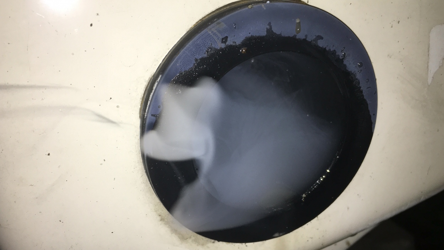

Starts up but only with choke then throttle. It will throttle up but won't idle, engine dies once I let off the throttle.
I'm on a trailer so only letting it run for 10-15sec with throttle.
Tons of water out of exhaust the first few seconds.
Thick white smoke is coming out of exhaust.
Not sure if it was fogged or if I am just brining the little extra oil I put in the plug holes before starting it.
Any ideas?
