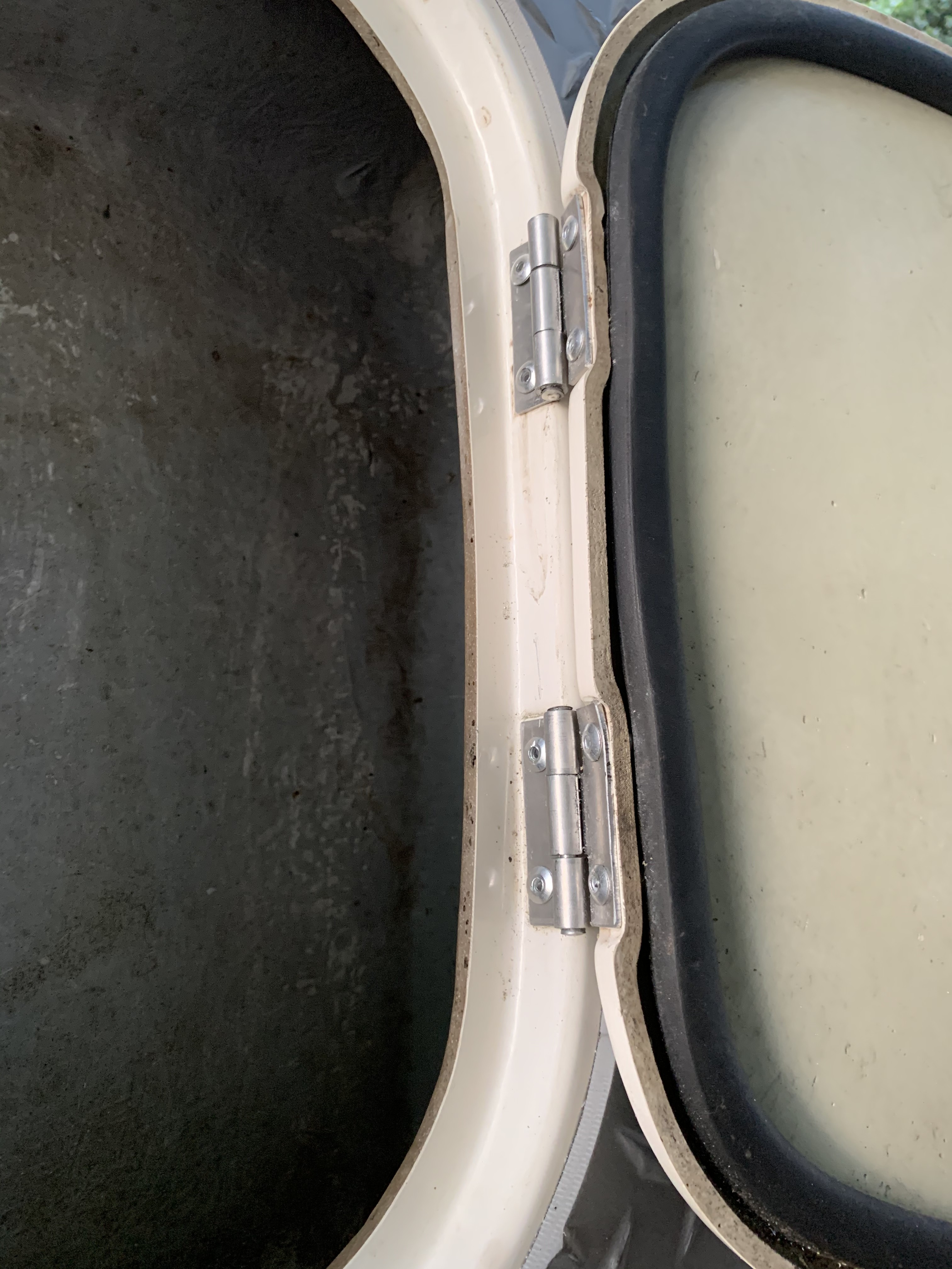

I purchased an aftermarket rope door from rgardner928 and here is the detailed install and some thoughts on it.
It wasnt an exact fit and took a trip to home depot and some work to get it done. Probably about 2 hours to install completely. Now that it's in it looks great, closes well, and I'm happy with it. The material looks like it's HDPE (pretty much industrial cutting board material) which makes it easy to work with. It does however have a little bit of flex to it and it is not as rigid as fiberglass. Also on the bow side of the door it doesnt match the contour of the boat and you can easily fit a finger under it, so it is not water tight. Not a big deal for me since I keep it covered when I store it.
Install:
The hinges arent an exact match to the OEM holes. In my case, I used a step bit to open the holes a little wider to give some wiggle room. 1 hole on each hinge lined up and the second hole needed to be drilled. I started by aligning the hinge holes with the rear/stern and tried the fit. The lock didnt line up with the catch on the boat. I switched it up and aligned the hinge holes with the front/bow OEM holes and it lined up the latch better so I went ahead and drilled the second hole for each hinge and tightened all the bolts down.
The initial install had the door really tight to the hinge side, and a big gap on the lock side. The gap was wider toward the bow and the latch didnt engage very well. I bought some more stainless steel washers and added 3 washers to each side of the bow hinge in order to close the gap. This worked well and the gap was pretty well corrected. This caused the back (stern side) of the door to become misaligned, and I used a dremel to sand a bunch of material off the back.
The final thing was the retention cable that was supplied was too short. I used some 1/16 stainless and made a longer cable.
Like I said, the install was a bit more complicated than I had hoped but it wasnt bad. It isnt water-tight but overall it looks good and I'm happy with the finished product.
See photos for details
Install:

thank you for posting your experience. why did you mount the hinges on the top of the door?
my ski rope door is oem and not the aftermarket described here.
i purchased random 2" aluminum hinges off ebay. they had no holes in them which was an advantage as far as i am concerned. i was able to drill my own exactly where i needed them.
The rope door arrived with the hinges predrilled and attached. Probably would have been better if the door arrived without hinges attached so I could align the door my self. Not sure why the hinges are on top- a previous post of the rope doors shows them installed the other way
