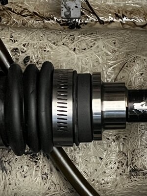

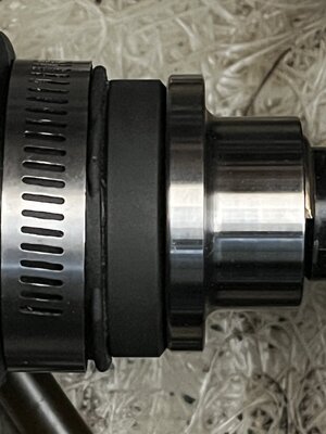

but for the time being on with the other problems, i noticed that the carbon ring does not line up (see picture) when it did run it sounded super rough from the area, previous owner said its just because its not in water ?? anyway, i cant find anything in manual about wether the rings should line up, if they should where is the adjust ment?

Carbon ring looks ok.

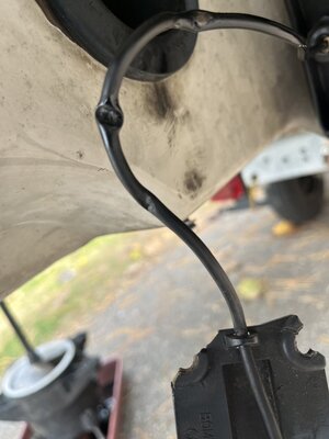

Ok people - i removed the pump and it spins freely - actually looks fairly new with the exceptions of o few dings on the blades. A little bonus find! the speedometer never worked and im hoping it was because it was pinched/crushed between the hull and the skid plate! (see pic)
