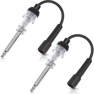

Check your plug on the oil (3 prong) Sometimes cleaning that up resolves problems. I always suggest having these around you can see the spark and what's going on. Good Luck !
