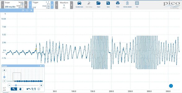

Here's an example of a faulty CPS sensor in my ski.

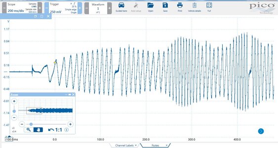

Here's what the signal should look like.
