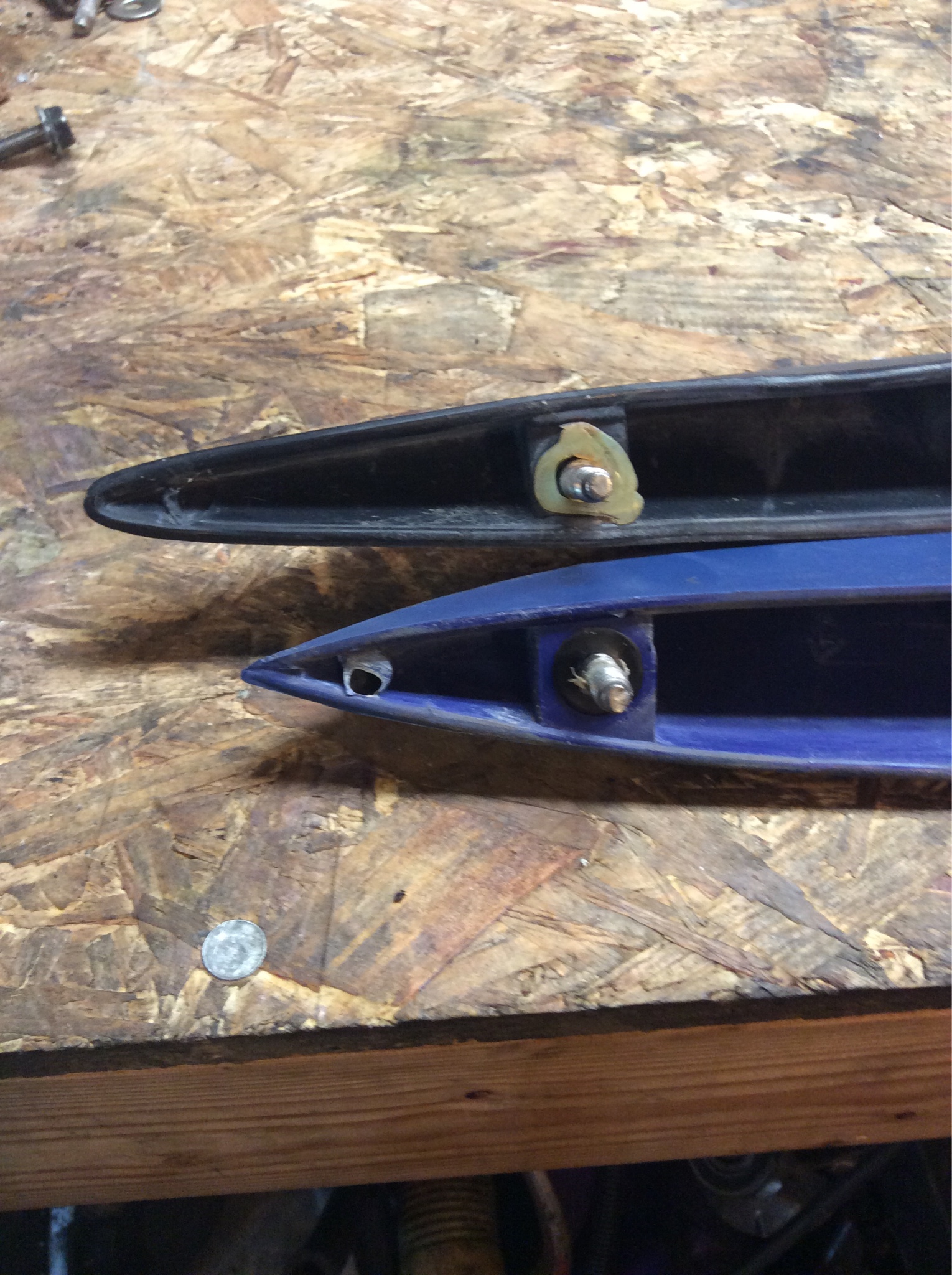

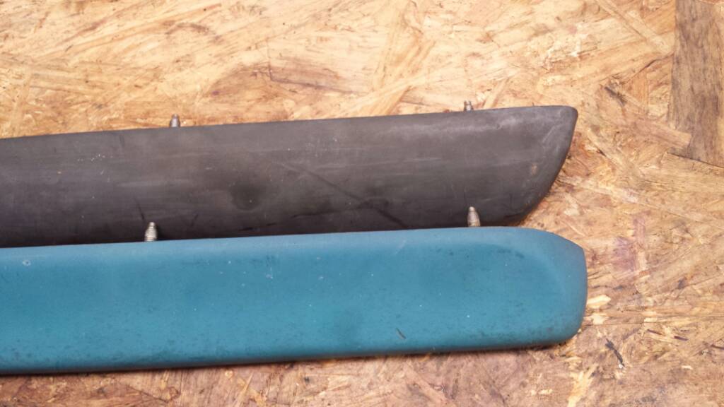

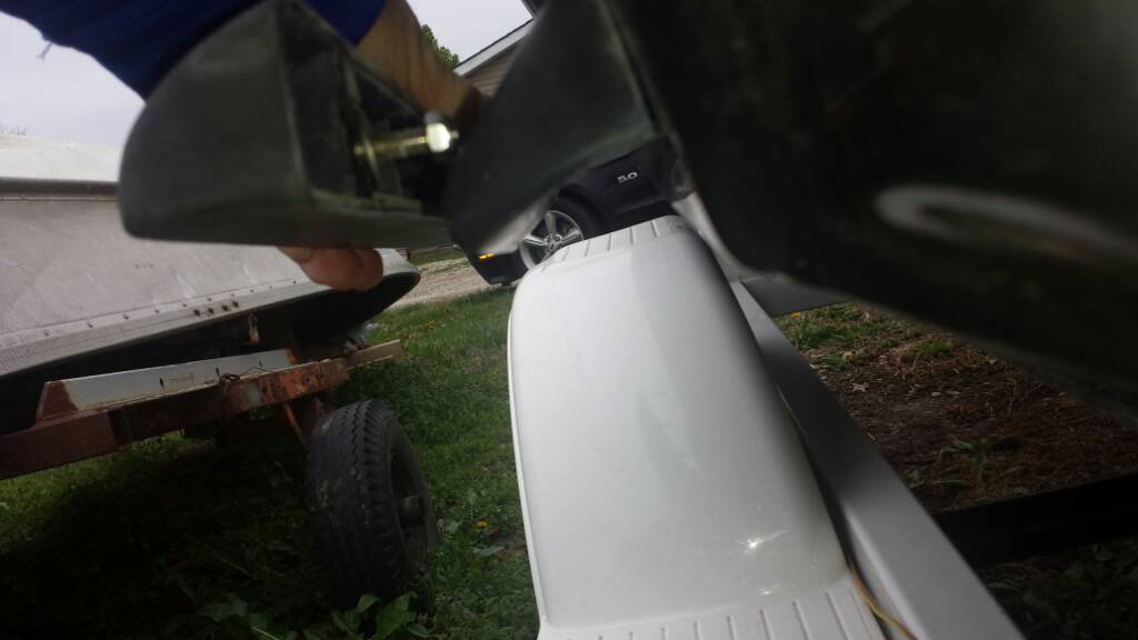

I can state, with absolute certainty, that 99 xpl sponsons will fit a 96 gsx. I even threw one on to verify.. because nobody likes fake news.
There are some differences, however I doubt it makes a squat vs the stock gsx.
The xpl has a rounded top vs a concave top of the gsx. The bottom is pretty much the same concave.
For giggles, I also compared the xpl vs the ones on my 99 gsxl. The gsxl is much more aggressive.
And now, potato pics. First pic is gsx on left, xpl on right. Second pic shows bolts lined up. Third pic is top comparison. Last pic is the gsxl vs the xpl.
Thanks as well. Is the xpl one longer. It looks like it in the picture, but it may just be the angle.

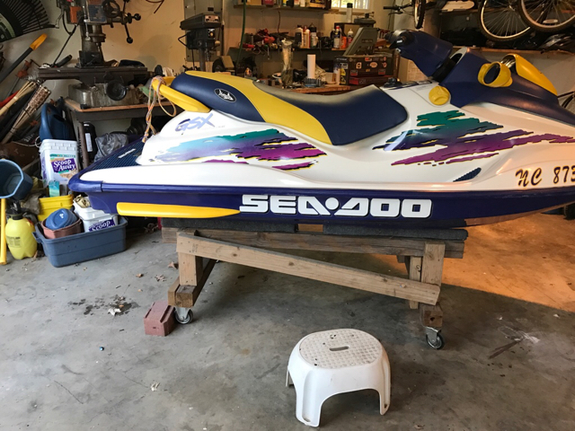

Love the yellow sponson....
That gsx looks great [MENTION=69521]soccerdad[/MENTION]

Thanks. This was my first ski, so she has always had a place in my heart. :) I like the yellow on the ski. The one behind the battery is not that bad. I had the battery out already so that saved time. I used a 1/4 drive socket set. I also put tape in the socket to hold the nut on. Then I used my inspection mirror and flashlight to look down the holes to see where the studs were. Then I felt my way in with the socket on an extension. Once started by hand, I put on the small ratchet and tightened them. Fortunately, they have a nice lead in on each stud. It was a pain, no doubt, but was easier than I thought it would be.
