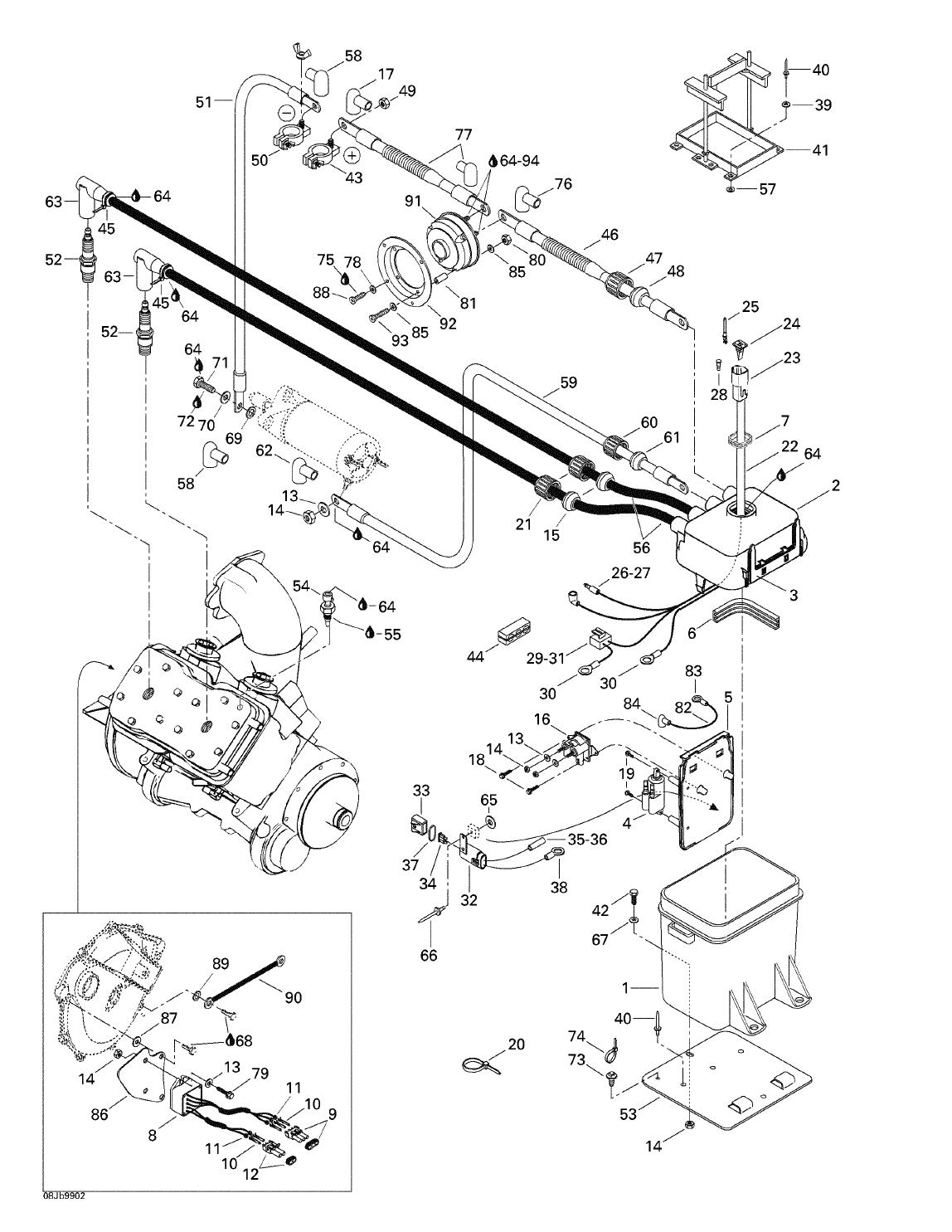

You should ave two RR's I think one on each motor has three yellow wires from magneto housing red wire and possibly black wire. Red is output of RR, if RR is defective pushing voltage up too high ignition malfunction will occur.
Pull both red wires to test simultaneously, or one at a time and still keep one charging circuit battery won't discharge if one is working you can still ride all day.
#8 in the lower left it the Regulator/Rectifier (R/R as Sportster calls it). You can just disconnect one wire, they're in a plug. So just disconnect the plug on the engine that is giving you issues. It should be mounted off the side of the mag housing. Disconnect the connector with the red wire.
Here is what you're looking for

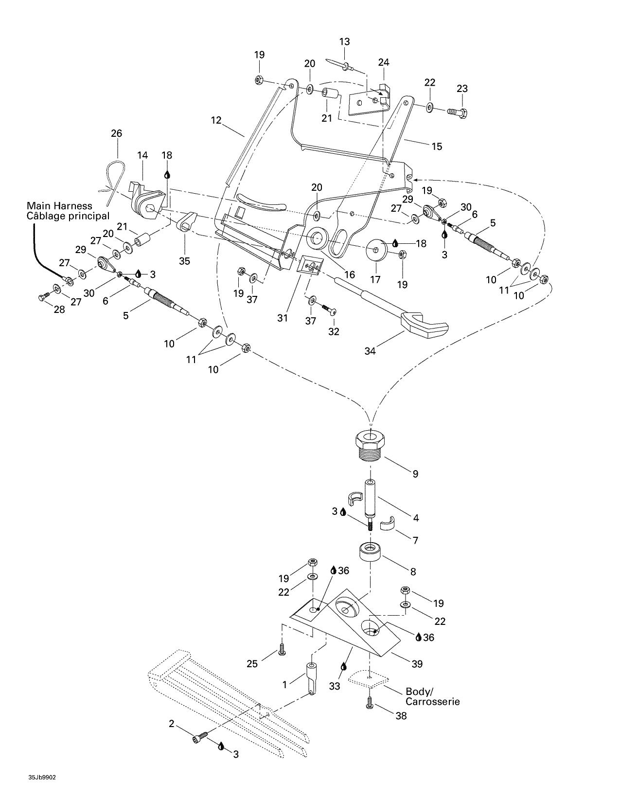

As far as the leak goes....just silicone the the exit point inside the pump tunnel. I never use mine. I'll also assume that the plastic seal nut is broken, that you might not realize and the seal is shot. You can get aluminum nuts to have better longevity.
#9 is probably broken in half--typical. That keeps tension on the seal. There was a guy on Ebay selling them, they were black and made from aluminum. Later skis use them. But it looks like OSDparts .com has a kit.
http://osdparts.com/index.php?main_page=product_info&cPath=595_602_7&products_id=8903
Kit pics for the weedless system
